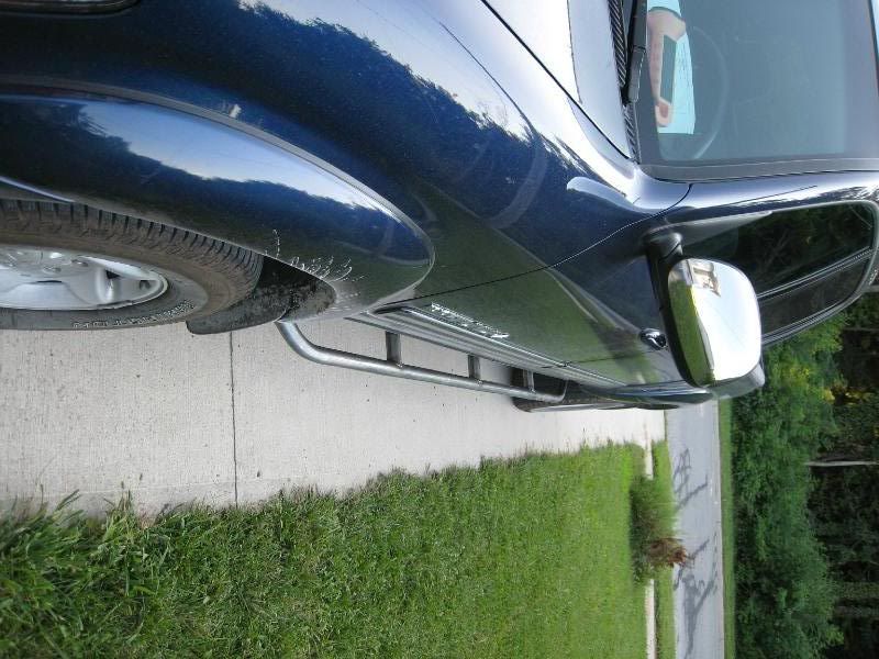

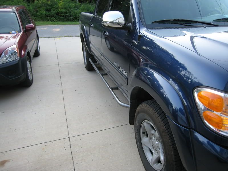

Sliders are Installed!!
Driver's Side:
Passenger Side:
Size check:

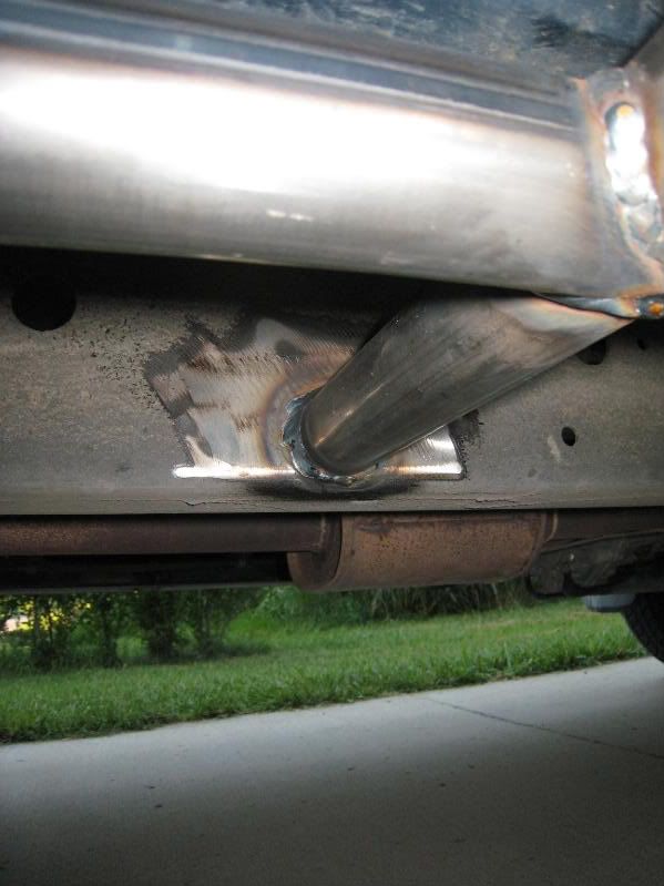

Frame Welded:
Duane at Techtafab did an excellent job of welding these sliders from scratch. I had him install the sliders level so they would be better steps and the boss approves.
I have two issues:
1) Got to decide how I want to coat the sliders. Bedliner type stuff or rattlecan with some skateboard tape on the top for grip?
2) When the truck crosses anything that makes the frame twist, the pinch weld hits the top of the slider tube welded to the frame. I think I should use my dremel and do some trimming to provide clearance and touch up the pinch weld with some paint to prevent rust. Any ideas would be welcome.

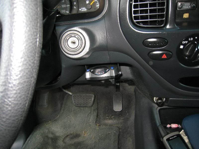

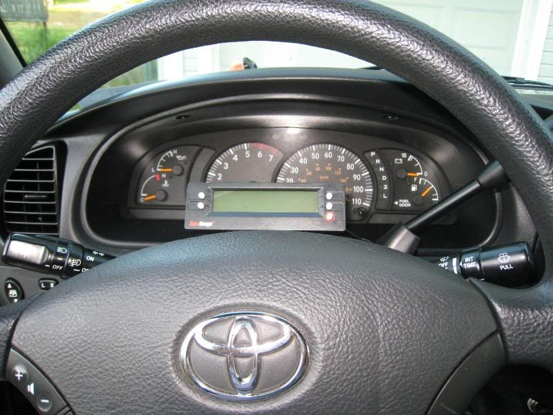

Also, got my Scangage and Prodigy installed:
Not entirely happy about the scangage placement. It may be moved soon.
bigwapitijohnny
Looking good...
These do look nice! Let me know if you decide to go with the bed coating...Any thoughts about plating the top?

Nuclear Redneck
Regards,
BWJ
Katherine seems pretty happy with just the tubes. Some sort of non-skid material will go on the top of the tubes. I don't think I'll install a plate.
Thanks for pointing me in Techtafab's direction.

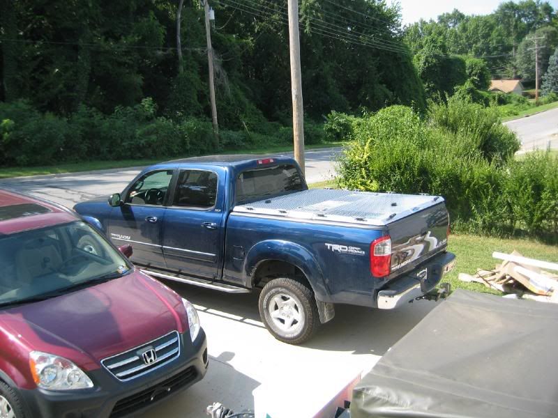

Latest Addition
WARNING!!!
Scott Brady and fellow chromepobes should not read further!:pROFSheriffHL:

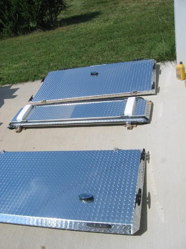

I got a box today:
All of the pieces:
Low Profile:
Shiny!!

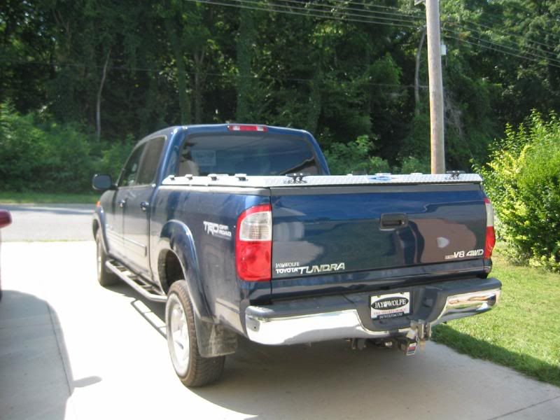

The cover is from Diamondback. Its rated to carry 1600 lbs. It's lockable and fairly watertight.

How easy does the prodigy install?

NICE cover!
That is a very stout looking cover! Me likes (if it comes in black, :hehe: , ah, heck, we could always spray some Rhino on it).
Great to see another Tundra buildup! :D
Well guys, whether ya like chrome or not, if he lets me put my cooler under that shiny cover I ain't saying no :elkgrin:. Seriously, I bet you'll have the coolest bed temps of anyone, with that cover!
I have a suggestion on the slider attachment...put a scab plate on the frame to support each leg of the sliders, then box the leg to the scab plate. Unsupported legs have a nasty habit of twisting the frame like Tedd's did back in the day LOL!

The prodigy is very easy to install...once you scour the internet looking for a picture of the pigtail plug Toyota installed under the driver's side kick panel.
My pigtail had a dummy plug in it and appeared to be fully installed and not a free pigtail.
Devinsixtyseven, I'm thinking about the gussets you mentioned, not sure yet if I'll do it though. This rig will not get any hard core wheeling, I just wanted something stronger than the typical tube step stuff.
Roundout, you can get the cover Line-X'd. They have some sort of deal with Line-X. I have thought about getting it covered, but in a light grey or something. I don't want a extra large oven, although that would be one way to do the camp cooking while you are on the trail.
