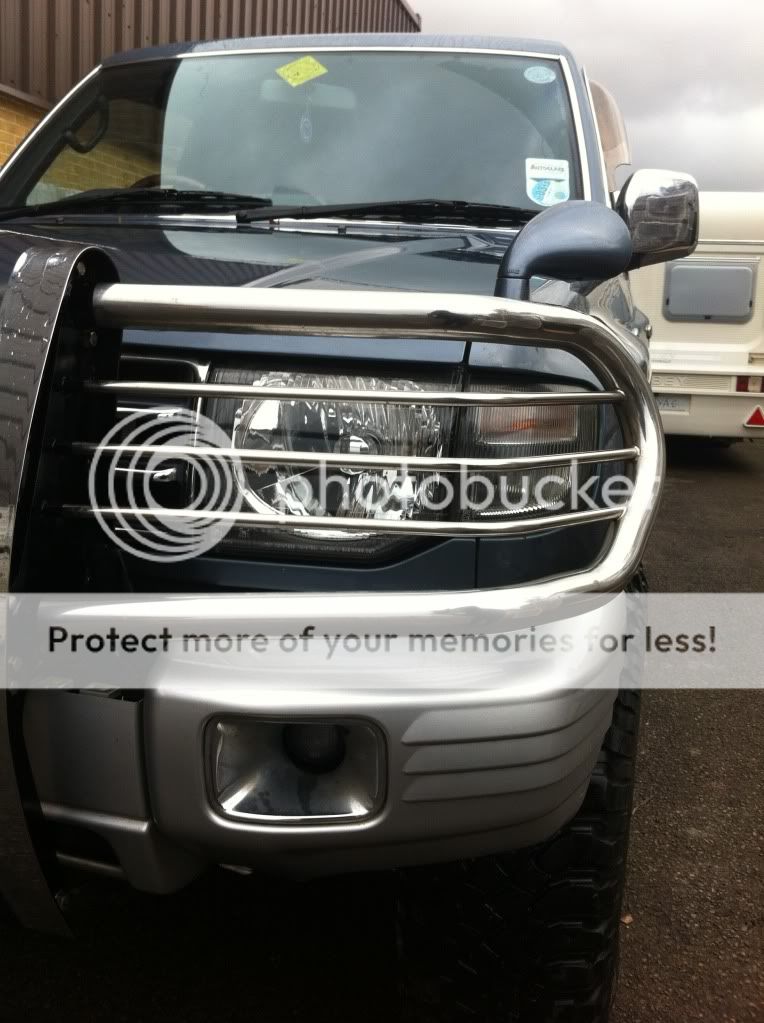

This is my 2.5 model Pajero(imported to the UK)
It's 3.5 GDI petrol, with rear locker, tiptronc gearbox and a bonus of seven seats.
It has had a 2" lift and running on 285/75/16 BFG muds.

The gen 2.5 also has blister fenders. The gen 2 had plastic fender flares on the SR models.

Skids, any idea what it'd cost to get some of the clear corners shipped to the states? Love the look of em' on a 2.5 gen.

Bididdy11, I can check the price of the units, the cost of the shipping you can check your end.
