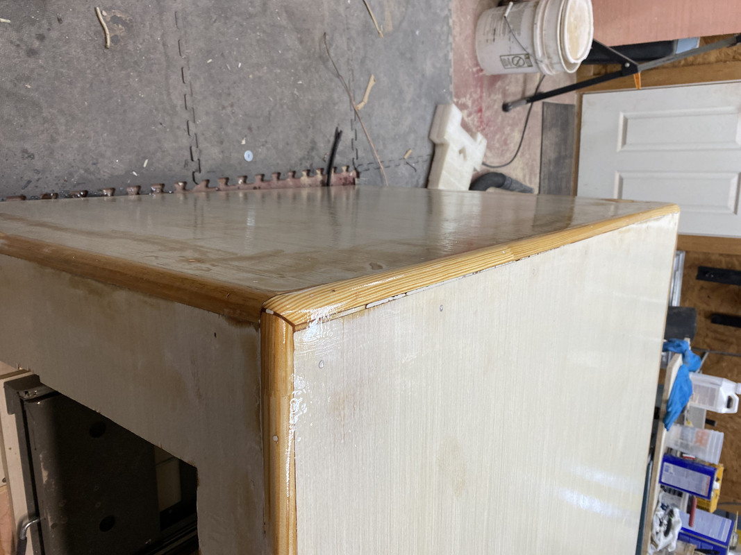

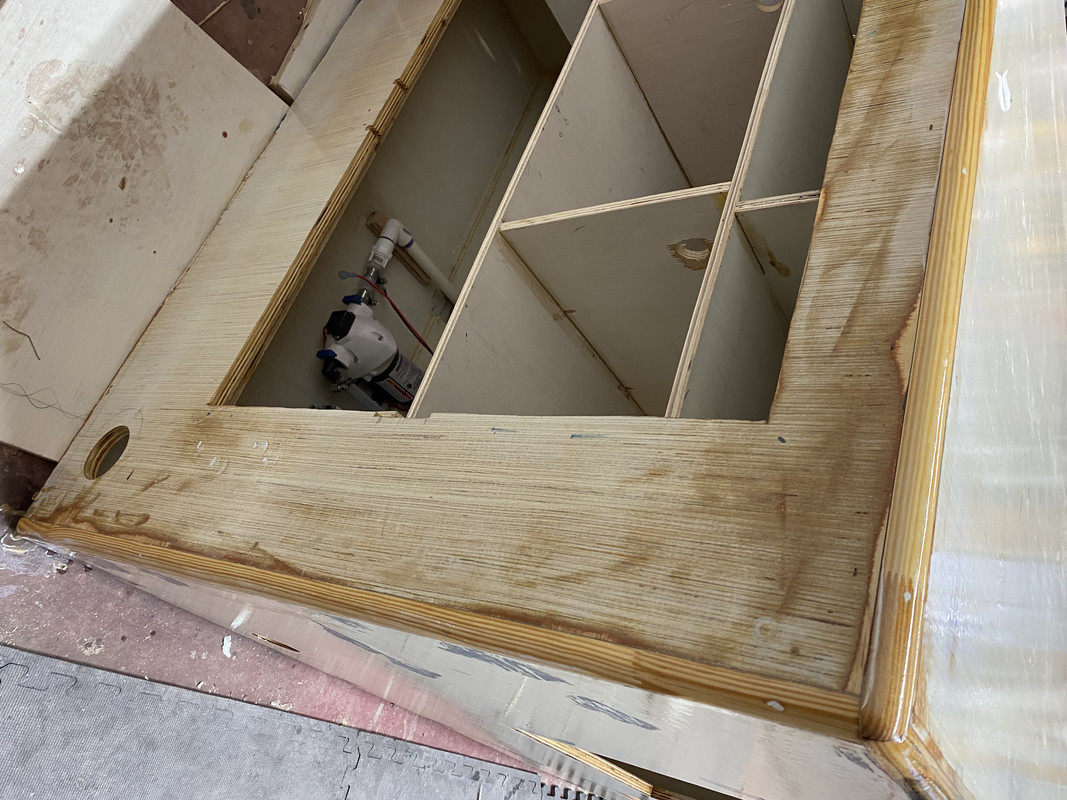

corners in and sanded smooth and round. 1st coat on epoxy on almost all holes sealed. next i need to weld some mounting brackets to the trailer frame and then the box will go in frame for the rest. should go quicker now i think.
