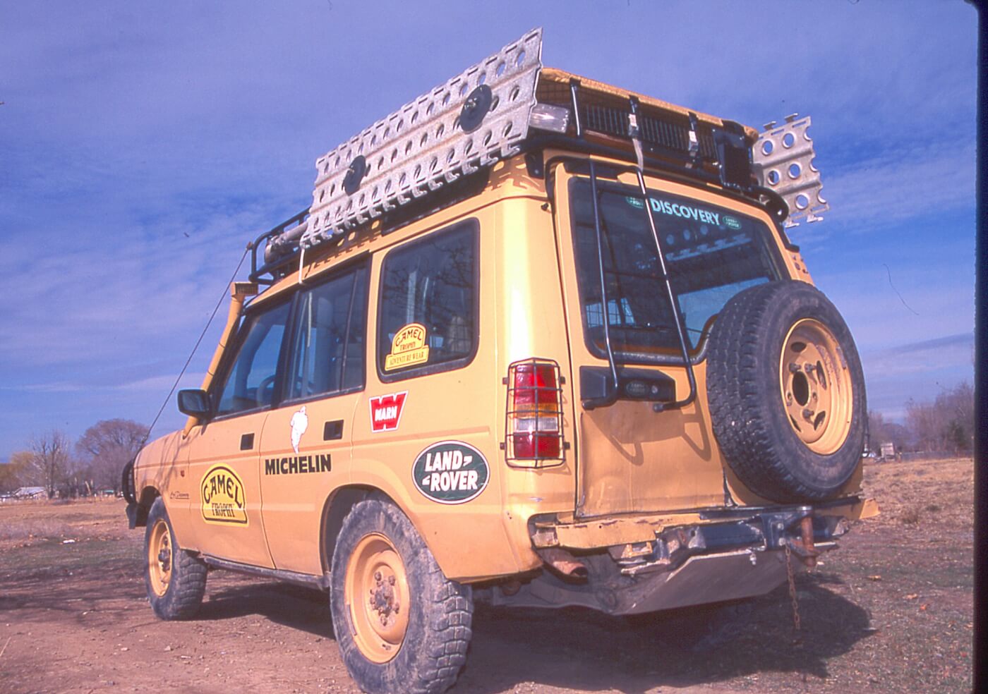

Did a short trip the past weekend, bit tippy, but brought some pro photographers with. Next build definitely leaning towards HCPU with cage and another husky winch... man those things work good. Another sandglow car might be a good call, shamel trophy or something ;)
Found this photo of an old SD prototype for the trophy.
I start to see where the sickness starts... there's always another landy that would do this or that job just a bit better.

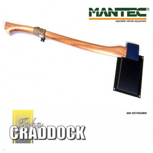

Tool Hardware Part II
(discontinued Mantec item, photo from JohnCraddockLtd.co.uk)
(photo from google images)
(photo from dieselworldmag.com)
Poring over old videos and photos, there was a very hard to find piece missing from the car (probably lost after the cars were de-equipped for post-trophy sale). The Axe mount is one strap for the handle, and a pocket for the axe head. A fellow from Belgium had an original one and was nice enough to have copies made. Thought the axe pocket was aluminum originally, this one is steel, something to check when I see another camel. The holes were also too small for the 3/16" rivets, so while I did drill this one out to match, I also do not know what the original size was for the holes. I would hazard a guess that they were 3/16"
One way I knew that the brownchurch rack on the car was original was because it had 4 holes for this missing mount. Popped right on in a few minutes :)
