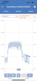

I have a CFX3 55IM purchased new on Amazon in December. I've used it on several trips without issue but now twice I've gotten Error 33, both when my flooded lead acid batteries were only around 30% discharged, reading 12.45v. The first time it went away after reset. The second time it happened repeatedly, including after I connected to shore power (over 13v) and only stopped when I connected directly to an AC outlet.
I have the CFX3 battery protection set to low and have confirmed via my Smartshunt readings that the lowest voltage registered is above 12v.
I did the wiring for the cooler myself following the recommended 10awg wire and its run less than 8 feet.
I'm guessing I need to contact Dometic for a warranty replacement? I wish there was a way to just disable the battery protection.
