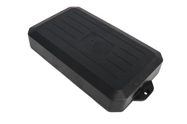

Not sure if it could work, but have you looked into those 4 way electric actuators controllers? Their purpose is to ensure all 4 actuators are synchronized.
Something like this?
There's also type that allows you to control all 4 individually from one control box:
Otherwise your guess is as good as mine :)
Cheers
David
Sent from my SM-G991W using Tapatalk
Hi Bruce. Good content as usual!
Thanks! Interesting controllers - something like that might work - but these don’t have any position indication built into them (hall effect sensors). Ill be getting back to the lift jacks very shortly, pretty sure the original plan is going to work, I just had a bit of a “oh crap” / brain fart at the end of that video!
