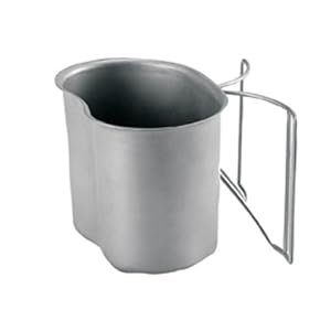

As for the lip, I wouldn't want silicone. Maybe you could thin/taper it somehow to make it cool a bit faster around the edge. I use one of these (actually several) pretty much daily, and the lip is very handy:

Not sure how we could taper the lip...it's made from a sheet of SS...that's a major issue right now we can't figure out (other than the silicone)...anyone have any ideas?

Not sure how to make the lip. You might be able to just chamfer the inside of the top to thin it out some so it cools quicker.
