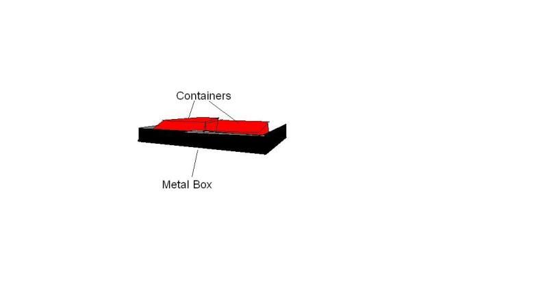

So here's what I'm thinking. I no longer have a spare tire underneath. I'm thinking to keep costs low, but to make an effective tank, what about using 2, 6gallon jerry cans. The space I'm working with is 24x34x8", I can't get too close to the exhaust on the driverside otherwise the tanks will burn.
So here's what I've come up with. (PLEASE excuse the horrible rendering... I'm not feelin it today)
So far the cans seem to fit pretty well under there.
Now, how do I fill them and will 12 gallons be enough?
Desert Dan
How would you lift them into place when full?
I think they would leak too.

Desert Dan - The tanks would be in a semi-permanent mount. I might pull them once and a while to clean them out, but most of the time they will be in use so they don't need to be lifted when full. I'm working on finding a better solution for a tank, this was just a rough idea. Like THIS tank
Spare tire is going on back.
Derek24 - Thanks! I love the firestones. Not bad on ice, just have to know how to drive :)
Vency- Thanks, hopefully I can find a tank that will work, so I can leave the gas cans at home

you might want to check out this thread - a bunch of ideas were already tossed around. for filling the tank, just cut a hole somewhere and install an RV or marine fresh water fill port
Backroad Explorer
Swim Welcome to ExPo, Have you looked at Moller Marine fuel tanks? Here's an example 18 gal. permanent mount marine
26.50L X 18.25W X 7.25H

Corax - off to check out that thread, thanks.
Backroad Explorer - Thanks for the idea. I'm going to research those as well.

I'm thinking about trying to do something like THIS into the rear door jamb. It's high enough that it can gravity feed, but easy enough to access and not visible from the outside.
