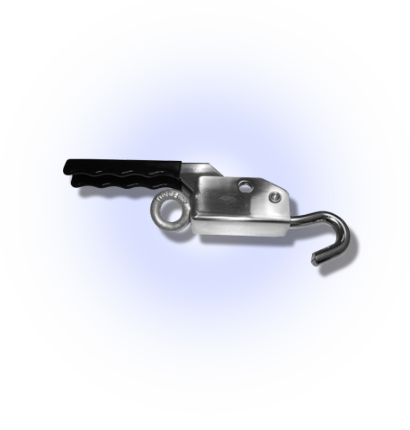

Thinking of getting a set of guns for the camper, Fastguns.
Fastgun Derringer
The factory turnbuckles are a bit of a bother to work with in the limited space of a Gen2 Tacoma. Not sure if these will be better, but it is worth a try.
Amazon or Ebay
Thanks to GCecchetto for the idea.
