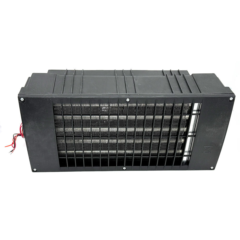

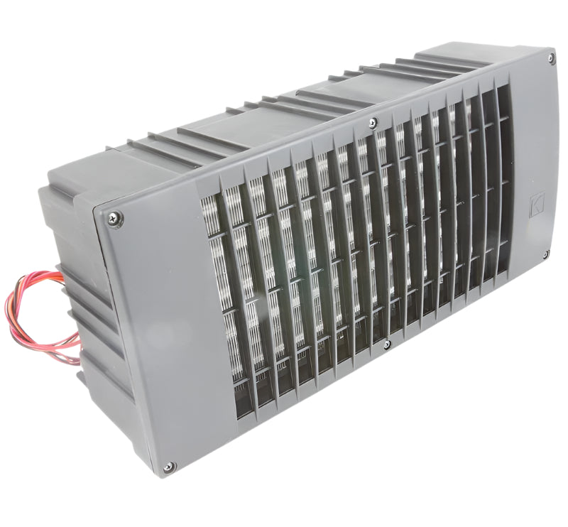

I read somewhere on here, someone said the system should be a higher kw output than the diesel heater's output for it to be efficient and minimal short cycling(?). The heater is 5-5.5kw - the towel rail is 175, the rad is 490, and I doubt the floor loop and calorifier make up the rest. Just a quick poke around found a super-quiet (46db) fan matrix putting out 5.5kw, 15mm copper matrix and connections, the fans draw 2amp max, and is a size that I squeeze it in somewhere.
I'm guessing the more heat I can output is directly proportional to how happy the wife is!

46dB is IMHO not quiet. I continue my search for less than 25dB. My current fans are variable speed (continuous not on/off) but still have some bearing noise. Its hard to find quiet small high flow fans. A few years since I looked. Variable speed fans also help with temperature control inside. Ten years ago I was also concerned about energy use. Now solar is relatively cheap.
