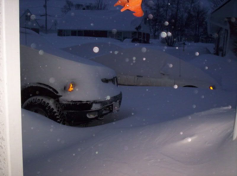

These pics were from last winter, at the time I left we had 18" of snow and my street, and the street mine is off of were not plowed. Had 24" by the end of the day and I was one of the few vehicles out.
