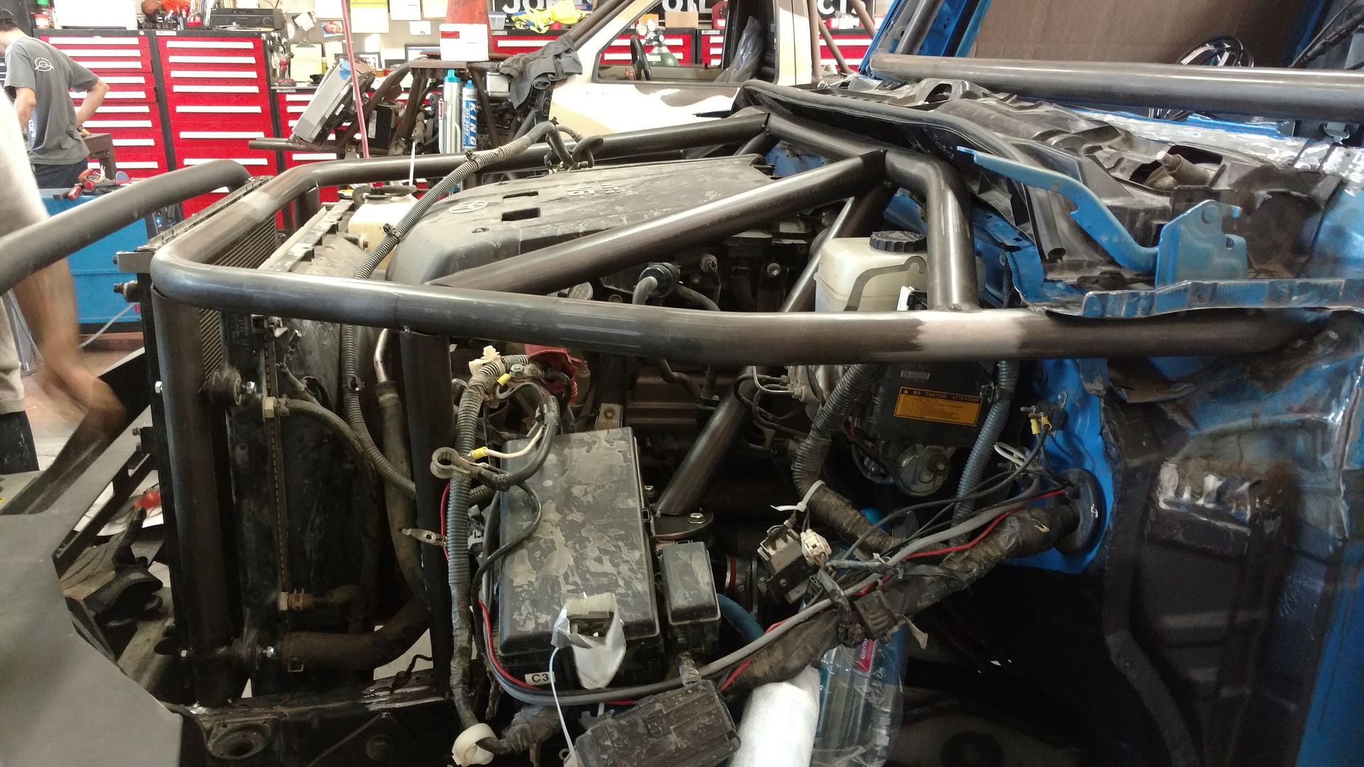

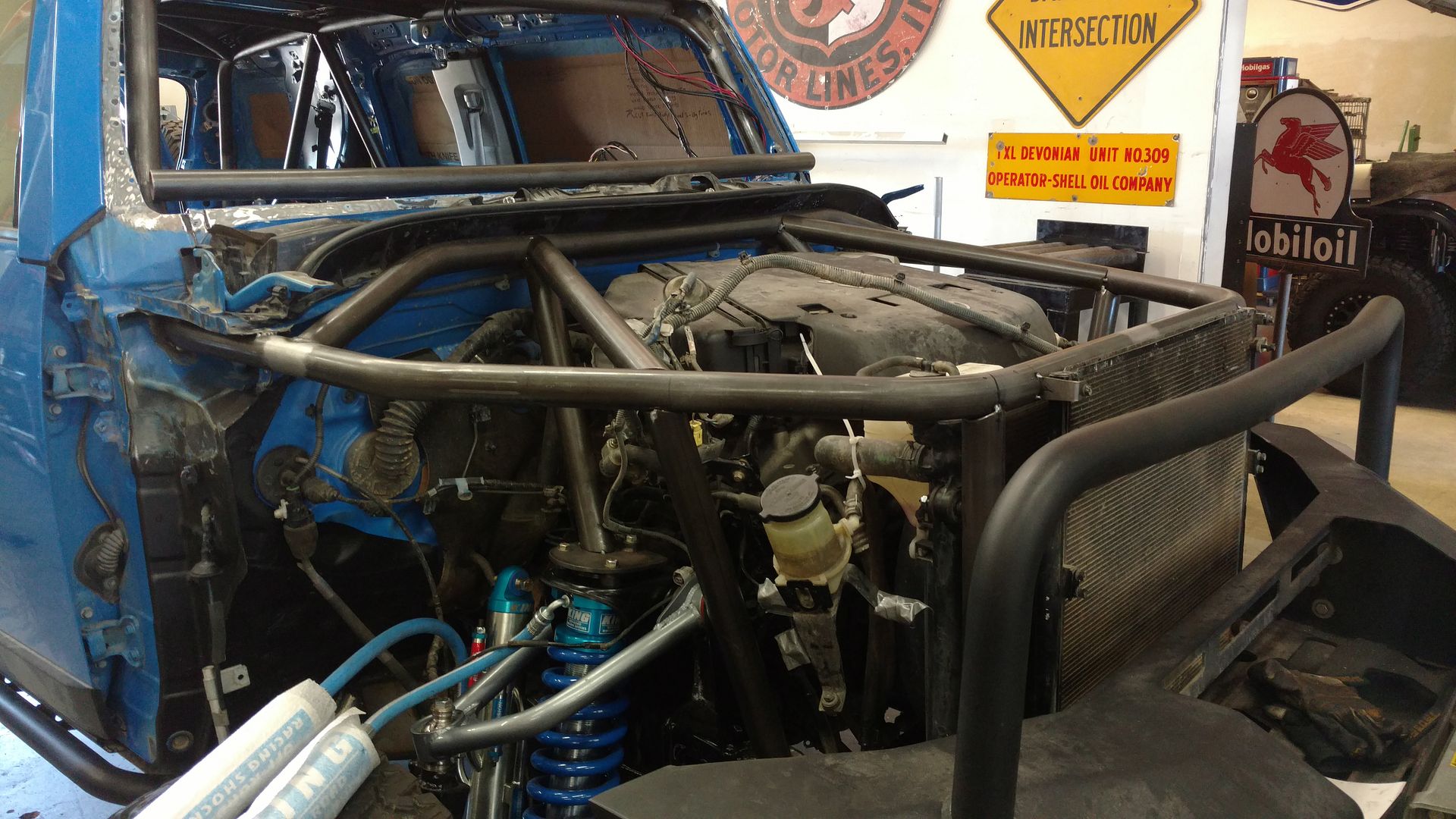

More build ing this week as we moved in to the motor cage! THe motor cage runs throught the fire wall into the cab cage.
We will be ditching the Total Choas shock mount for the bypass and build are own! There's doesn't really do with what we are building. As you can see no sheet metal and no core support. That means all new mounts for the radiator and misc things under the hood.
More pics to come!

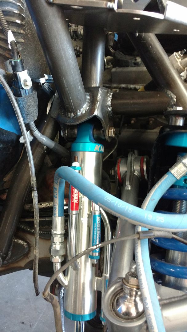

Toyota J Cruiser bypass shock mount.
today was a busy day as we got the new bypass shock mount made...

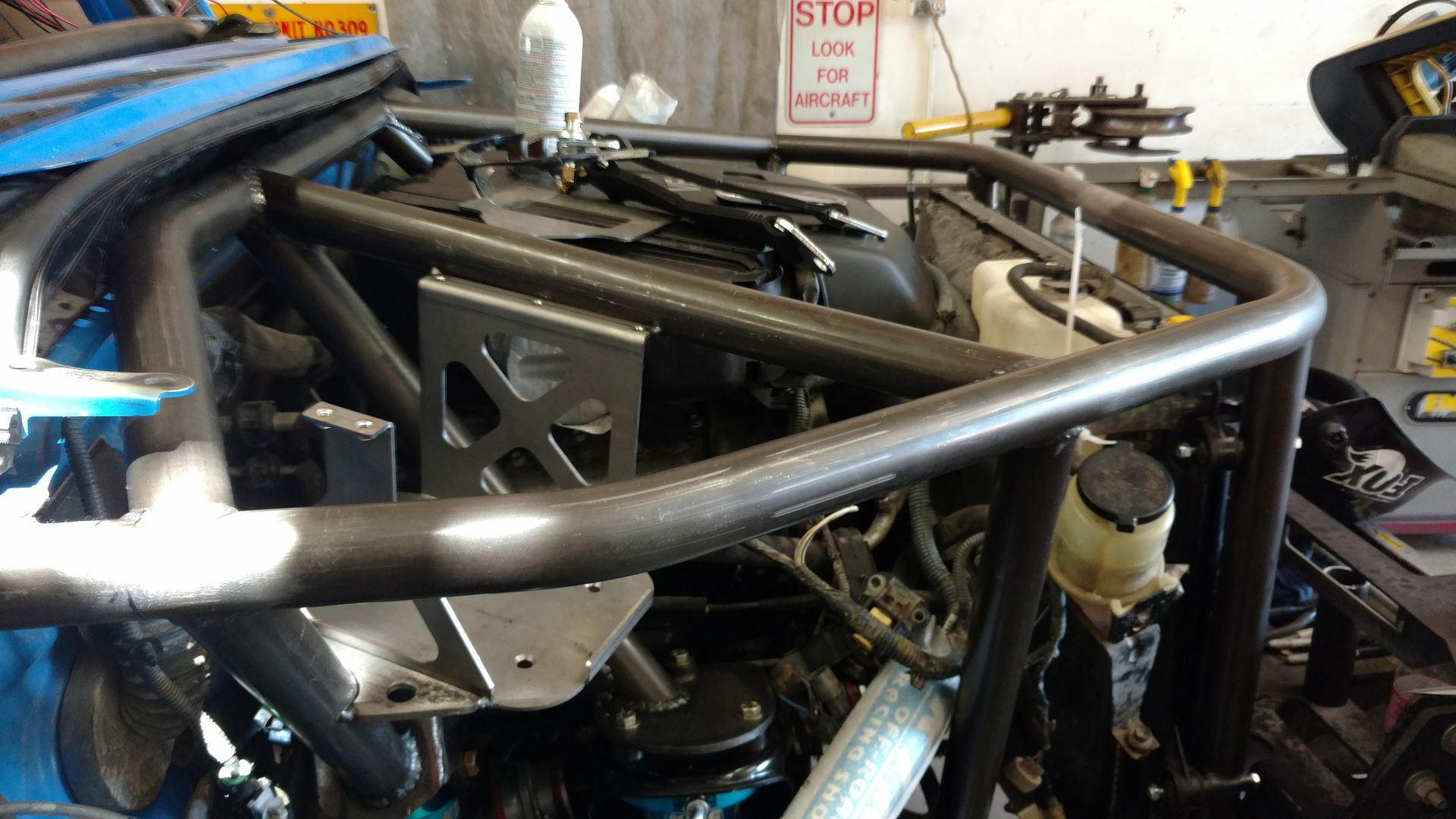

Along with a battery tray mount.
Next we are going to start mounting all the little things that go under the hood like fuse box and power steering reservoir.
