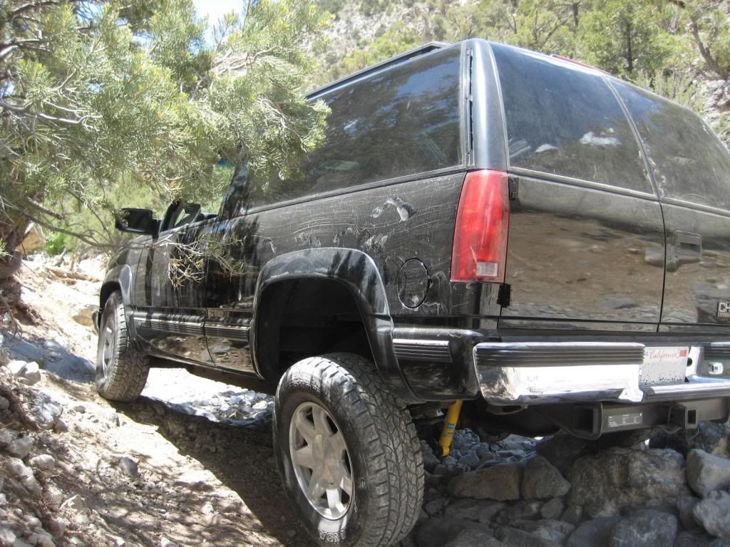

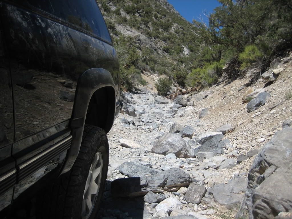

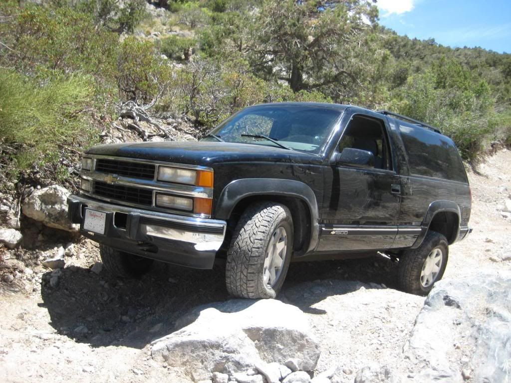

I love my Geolandar's A/T-S 265/70R17
Good traction on granite rocks.
Tough enough for rock gardens! They're nice on dry gravel roads and hard pack too. Havn't had the opportunity to try them in mud, snow or sand, yet... But I imagine that a more aggressive tire would be more appropriate if you expect to encounter a lot of those conditions.
So far they seem to have a healthy tread life, despite a worn out front end on my Tahoe (now fixed) for the first 10k miles, no irregular wear whatsoever! 15k miles as you see them in the photos. Excellent traction on the highway, wet or dry! You can get them to break loose if you push hard, but they feel predictable, no drama! Quiet running tire too. And VERY affordable; I paid $525 shipped from discounttire.com. However, that was for a 'D' rated tire. I'd definitely get the 'E's for your application.
