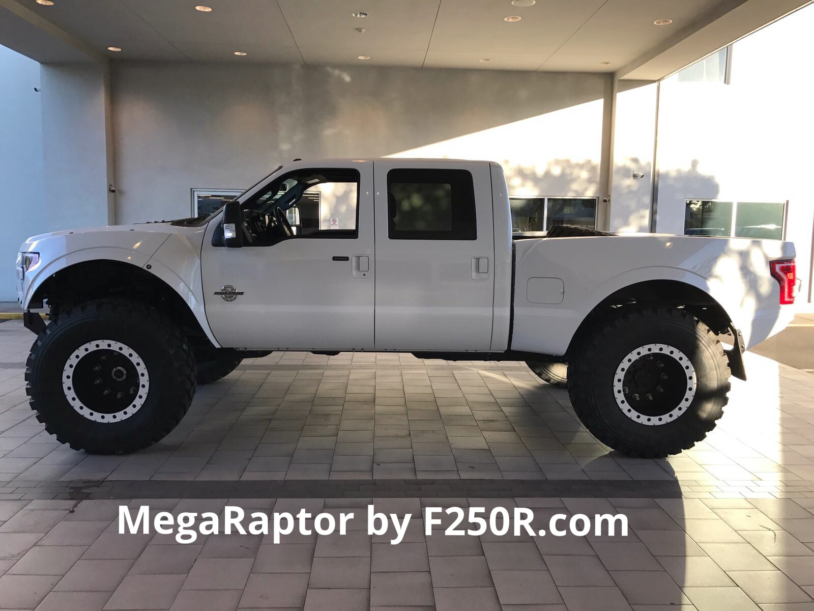

46s look right to me
https://www.megarexxtrucks.com/megaraptor-46s
