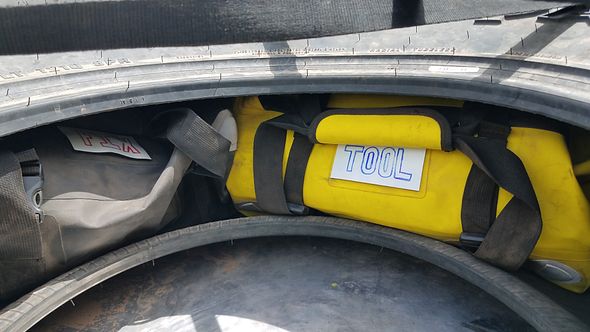

Here is my current tool bag in my #LX45....

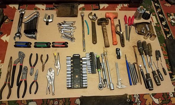

I keep a similar tool bag in most of my vehicles. These are built in my #TitanToolBag and I generally build the kit(s) around that available space. They aren't typically packed full as I HATE having to fight to get things in and out. I typically also divide and organize the types of tools into smaller bags to help organization.
I try and included some of the tools that make accessing and repairing bigger systems....spindle nut sockets, pinion nut sockets, etc. All this stuff isn't top dollar at all, and I have sacrificed a tool to make a trial repair or modify it to access something. Things like a small TRE puller can be extremely handy and make repairs 10x quicker on things like a bend tie rod or replacing a TRE. A simple slide rule makes it 10x easier to cross a seal or bearing when you are in a pinch....or trying to modify something to work....and it weighs next to nothing.
Even if I can limp to a town for parts, having the tools to install the parts has a lot of value for me. Having to buy tools on top of parts to fix something adds another layer to the headache.
