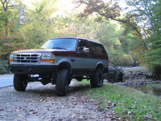

I second the old or new Full Size Broncos. 35's will fit stock with sheet metal clearance and a set of fender flares and will hold up to a lot of abuse, 33's are even easier. Plus you can SAS any 1980+ pretty easy if you get the need for more off-road capability and rock crawling.
But I'm biased:
