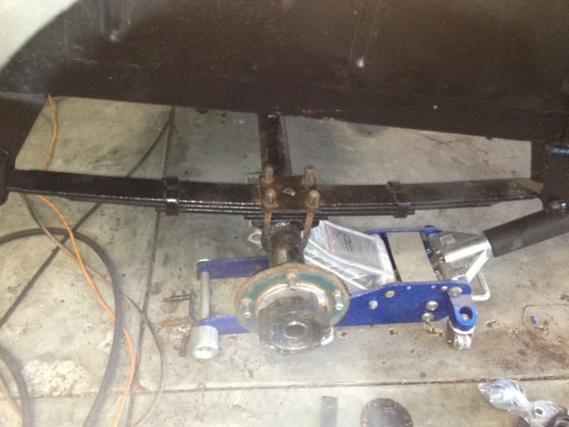

I went by a trailer place and picked up 5/4.5 hubs cause I read this could be done. This will not work. The a typical hollow full floater spindle is to big for a normal 1 3/8-1 1/16 trailer bearings.
Are these the right springs for a BT3-C

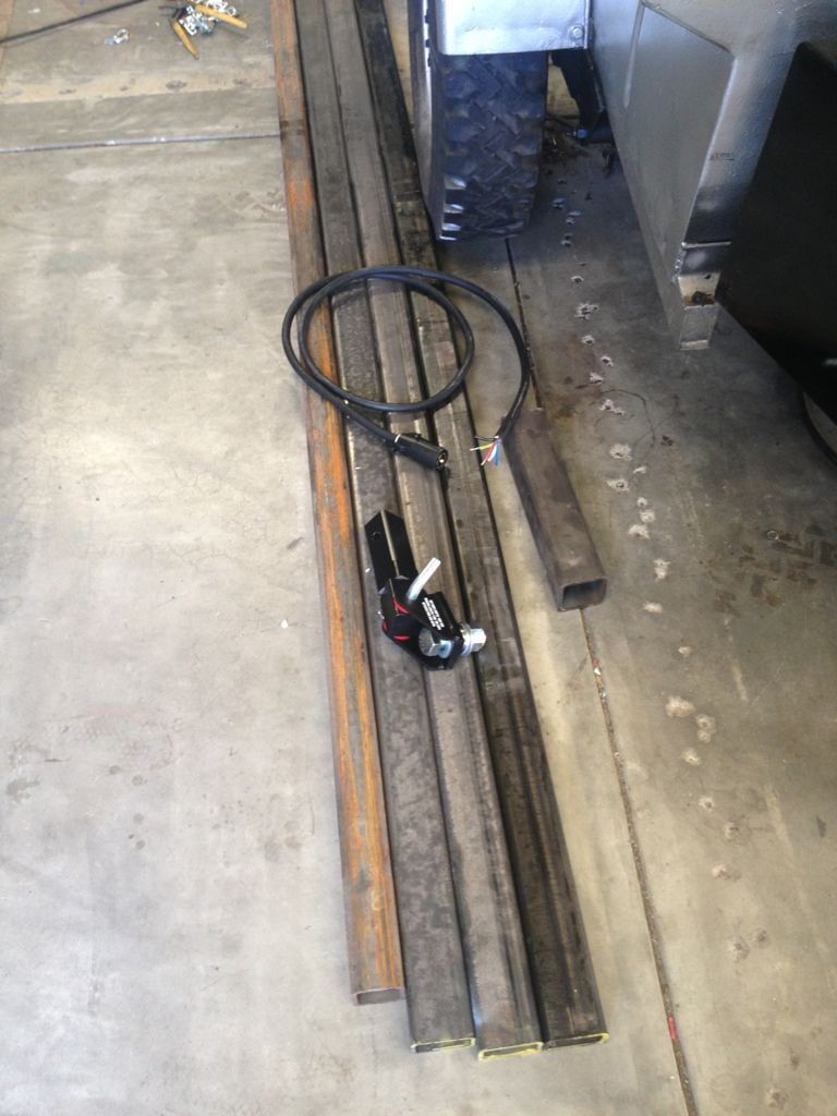

This shouldn't make extending the tongue to hard at all. But I wanted to add a box on the front for battery's and maybe a future water pump. This will complicate the simple extention to almost 4' to clear my tire swing. That means a new a-frame tongue. Decisions

Picked up some steel for the tongue yesterday. The max coupler arrived also, and the kodiak tent. No work will be done today. I'm taking a few newbies up a local trail. Hopefully I can work on it tomorrow before I head back to work.
