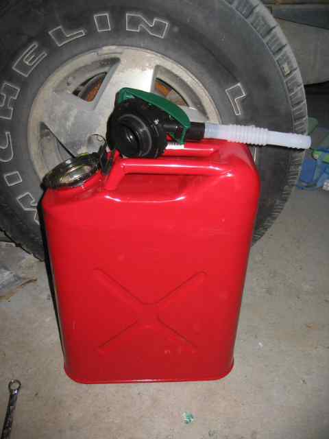

Hi JS
i recive my jerry canne form pjf4x4 today
and i planed to buil one carrier for it
i like this 2 model ???
if possble to make one holder for you ???
Pascal
