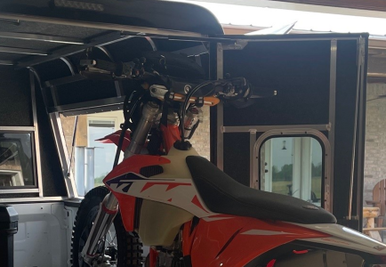

OK, I give up, how did you get your bike to stand up for this picture?
I left it in gear and just leaned it against the door :-). Lot less scary loading a bike in a lifted truck when you have the security of a wall/door close to you that you can grab and/or lean the bike on if you need to regroup vs. a tailgate. And you can step from a stool to the bumper.....don't have to go all the way to bed/tailgate height all at once.

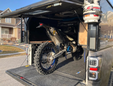

My bike is around 50" with bar risers and barkbusters. The ARE DCU 36" above rail shell with barn doors had a rear opening of 52". Plus you got some help with the bars entering the camper while the rear tire is still lower on the ramp. You can see in my pic zoomed in with bike right at that point, there is a couple inches clearance with that ARE shell. I'm worried a Project M with the tailgate in place is going to be a pain, even if you compress the suspension on the bike with a ratchet strap. Ford bedsides are 1" taller than Ram so that helps at 21". Add the Project M door height of 26"....gives you 47" clearance. A while back I found a company in Europe that sells a little wheelbarrow looking tire to install on MX bikes for loading in the back of cargo vans. I tried that at home with a tire from Tractor Supply....and backed out, it was a pain but that is still an option. I would like the bike loading to be as easy as possible. The receiver rack is certainly the easy button, I just know at times I would like the option of the bike inside for multiple reasons. And with a long bed on order.....now I could have the option to put my KTM 950 Super Enduro inside and my 450 outside :cool:
