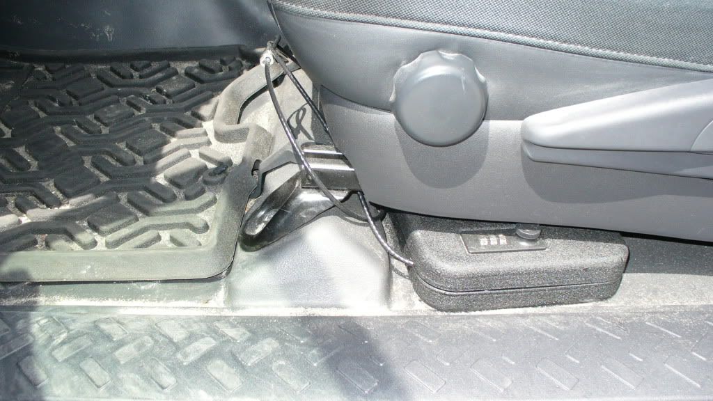

I have one of these leashed to my seat mounts. Probably a bit small for your needs. It's just big enough for a full-size auto and an extra clip with eggcrate-style foam on both sides. Not my ideal secure storage (saving pennies for the Tuffy Console Box), but it's very well hidden under the seat. This positioning of the leash and the box was just for a picture...
Lemme see if I can remember where I got this thing. There might be something bigger...
