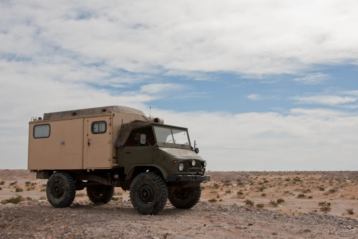

A ways in to New Mexico, en route to Los Alamos, the truck suddenly started slowing in 6th gear on about a 6% downhill grade. The feeling was like shifting in to fifth with the throttle closed. Examination showed the transmission to be hot enough to smoke the gear oil. The transmission did not reliably shift into any gear. There was no grinding or sheared metal in the transmission oil, but the one week old change of GL4 90wt had a burned smell to it. It also had a consistency incongruous to that of gear oil. The poor mog is still on the side of the highway. To be continued! (fingers crossed)
-CJ

Update: drained trans, filled with Amsoil MTF. Gears still stick, neutral dosen't work, and I only have 1st and 3rd gears. Looks like I'm in the market for a transmission, and have a need to remove my cab and engine. Ouch!

Update- Just got back down to Twentynine Palms with a new transmission for the Mog. Much thanks to Scott and EI for making these things available! It wasn't quite smooth sailing though.. I was driving my Range Rover, and while non-leaking rovers may be the ones out of fluid, mine has developed a massive transfer case leak. No fun to top those things up hot on the side of the road. Also, the accordion pipe on the intake gave out. It is constructed of what looks like a long loose coil spring with an airtight cloth material laminated inside and outside. The inside layer delaminated, causing the intake vacuum to suck it shut and stall the engine. The quick fix that got me the remaining 300 miles down here was an old spray paint can with the ends removed fit into the pipe. Photos soon!

Well, a final update on this one.. New transmission in, and the Mog lives on. Many thanks to Scott at EI, the staff at the MCCS Hobby Shop, and everyone else who lent a hand putting it back together.
