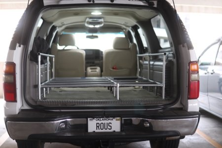

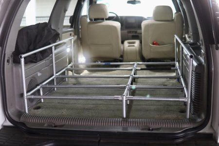

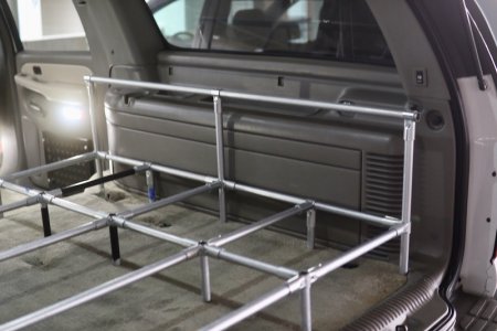

Starting the interior build in my 2000 Suburban 2500 overlander using 3/4" conduit and MakerPipe connectors. Planning two main pieces - the bed platform then a side cabinet for water, fridge, and house battery.
I didn't like the idea of blocking the rear windows for storage cubbies, so designed these retainer "wings" with plans for some dedicated duffel bags for those spots. This keeps the windows clear, leaves access to the OE storage cubbies, and access to the spare tire jack. Also lets the subwoofer breath.
Platform will get some sort of hard surface (plywood etc), and then 4" drawers underneath.
