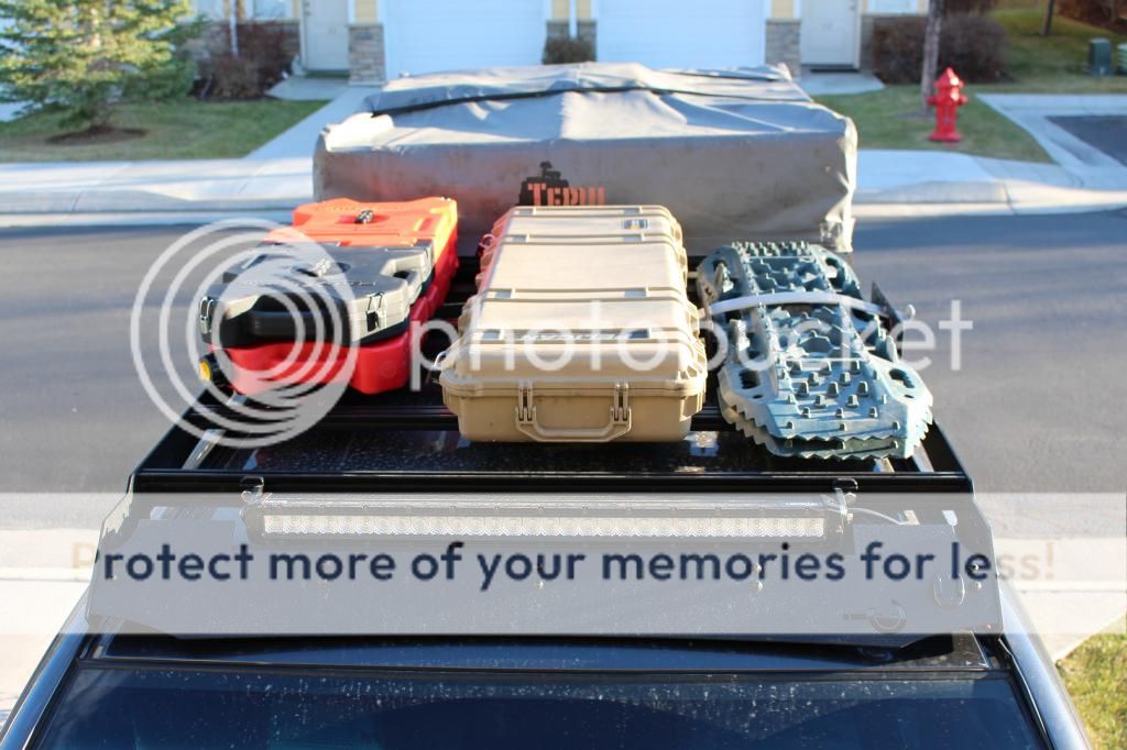

ventura911
I use two cases for recovery gear. Other than fading to gray, no issues here:
Attached with CaribouCargo locking mounts.
