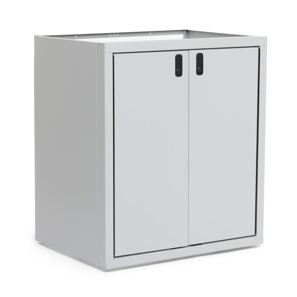

We ordered a RB components base cabinet, and I’m fabricating slides for the fridge. Man, it’s a tight fit, but I think it’s going to work..

If anyone is wanting to use the 50liter ARB fridge and do what I did, hehe, it’s a really tight fit and you need to be spot on for it to work. But ultimately I think it’s a great way to go.
A little more detail on the setup. This is a stock RB base cabinet, and I modified it by adding McMaster sliders. The sliders are easily rated for the weight, and extend 2x their length so they are perfect. The clearance is fine except when you consider you can’t swing the doors open 180 degrees inside because of space. So it gets really tight and I had to band saw off a bit of handle plastic to make it all work. I removed the feet and screwed the slides right into the mounts where the feet are.
