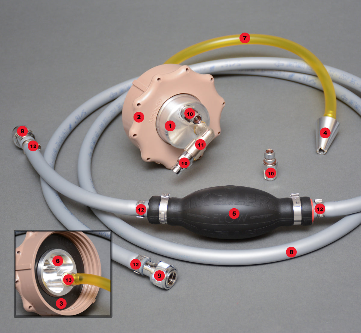

This is a really nice kit for converting a scepter MFC into a fuel tank:
