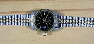

This was in a batch of old stuff in my mother's house - may have been from my grandmother on my father's side but I have no idea for sure. Could be a fake that my mom picked up in her travels.
