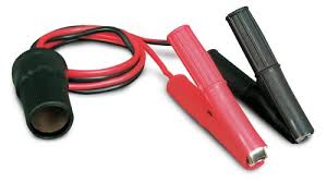

Assuming this is the newer ARB 50QT unit as it has the error light. What level do you have your battery protection set at?
Just to narrow things down you might try building a simple jumper directly from your battery to your fridge, ie something like this:
images
Do you recall what size wiring you used in your wiring? Assuming your ground runs all the way to the battery as well? Fwiw the ARB fridge harness kit used ~10 guage wiring.

After doing a little bit more testing I've decided that it is indeed the battery. It's currently plugged into a wall socket via an extension cord and is running just fine. I tried plugging it into the OEM socket in the dashboard with the key on and it did the same thing as it was doing before. Once I started the engine, it ran just fine... So I guess that's the next thing on the list; new battery. Maybe while I'm at it, I'll just go big and do a house battery while I'm at it. Any recommendations from anyone on the size/type of battery, where to mount it, and the wiring to go between?
I'm not very electrically savvy...I know enough to get myself in trouble, but I'm pretty good at following straightforward directions. I would only be looking to run the fridge (ARB 50qt), led rope-lights in the bed, and an air compressor on occasion.
