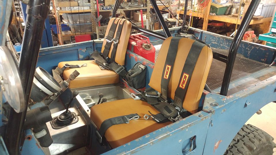

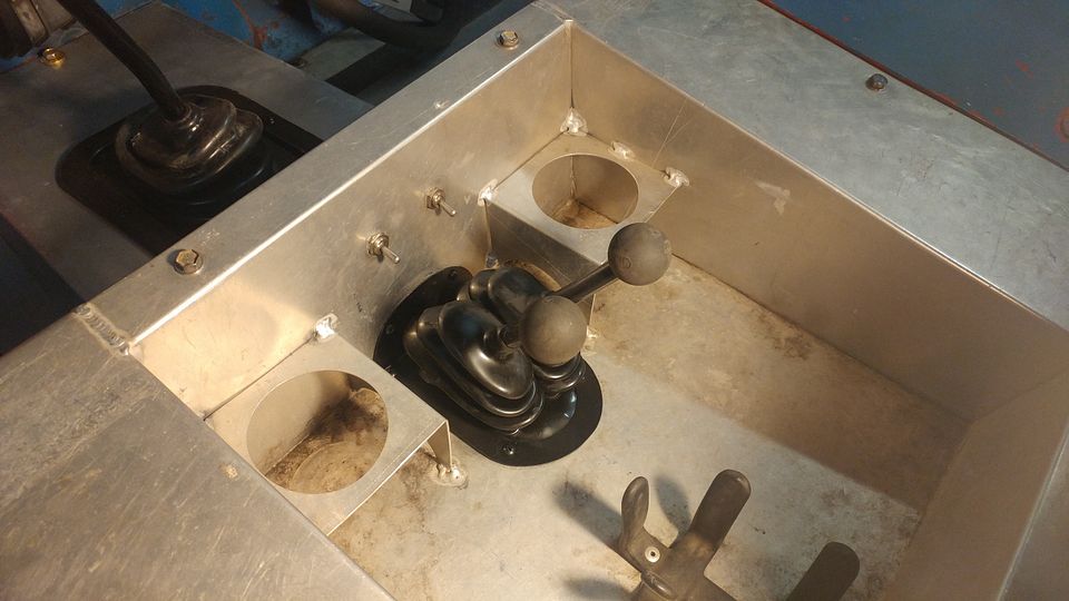

Made a console for my RRC about 10 years ago
Ok, need some clarification on the three shifters. I see the manual transmission, the normally located diff-lock shifter, but what's the hi/lo shifter for off to the right side of the console?
