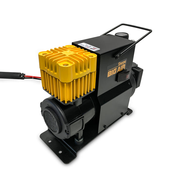

What else on the market that is between an ARB twin and Oasis electric air compressor? I have an ARB twin in my old Jeep and it is a good overall package, especially since it fits under the passenger seat and is decently quick with the 35" tires, but I've been wanting more lately. I run a 40" tire on my #LX45 and a 12V Puma compressor and while it works ok, I want more. The 12V Puma is a solid performer against the ARB honestly, but I am looking for something more.
The ARB twin is 4.68cfm at 30psi
The Oasis is over 10cfm at 50psi(!), but I admit the cost and size is hard to swallow.
What I am looking for is something between those two. It needs to be 12V in a rather tidy package and a solid value.
The only thing that has come up in my research so far is the Sherpa Big Air. Is that the only other option for an 12v electric compressor in this class?
The Sherpa is listed at 8.9cfm at 30psi which sounds in the ballpark for sure!

I have a Sherpa Big Air. Personally I would not buy another one. Problems with the valves, poor wiring, original tubing supporting the quick connect broke. I’ve completely rebuilt it twice. When it works it is fantastic - for about 10 tire fills and then something else fails. Great concept, poor execution.

I was about to pull the trigger on the Sherpa, until I read a few reviews with quality concerns. Eventually I bought an Oasis XD4000. I already have a Puma, and a bunch of Viairs. Figured if I'm going to upgrade may as well go all the way!
Other than quality issues, look at the max psi of the Sherpa - very low, that tells you the motor is at the limit (essentially over-geared). The Oasis can output 200 psi at 100% duty (100 psi on the XD3000). This means pumping 80 psi E-rated tires it's barely breaking a sweat. Heck, even 110 - 130 psi commercial tires are a piece of cake.
The quality is absolutely beyond anything I've seen, and the weight as well... The York compressor was meant for decades of AC service, not close to the pump on the Sherpa.

I have my reservations about the York style compressors coming from using them in engine driven OBA applications. They either seemed to stay alive long term BUT had a healthy amount of blow-by oil in the air stream that could not be removed with a filter ( and ended up coating the inside of all the tires ), or they had dry air and didn't last long term ( especially at higher engine speeds ).
I think the Sherpa ( for better or worse ) was designed to be a large bore low pressure compressor. Honestly, for a lot of what I do ( filling tires ), that would be just fine. I don't really need 100+psi for very much. The long term quality is what I am most worried about at that price point.
