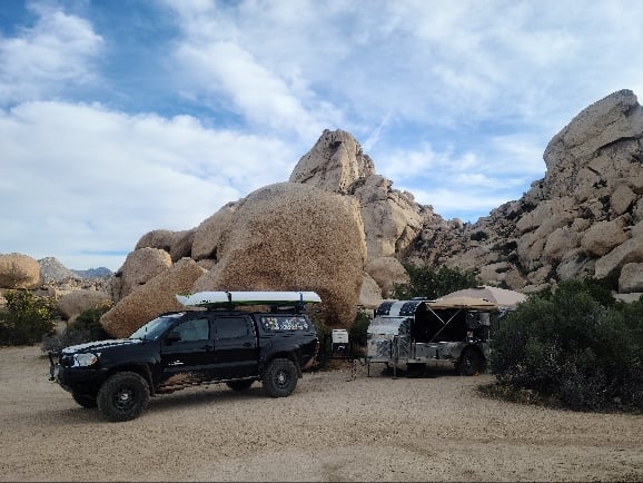

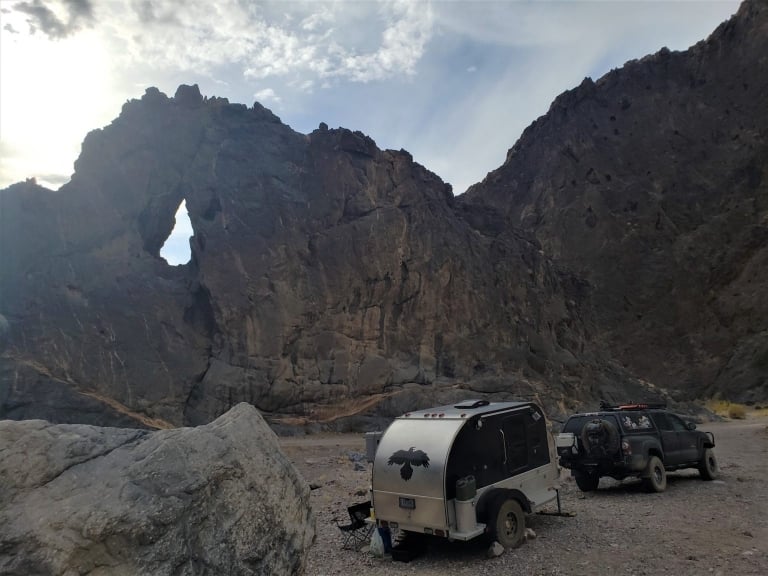

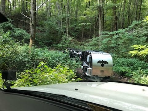

The beauty of a trailer is the ability to park it and run the trails you want, coming back to a nice comfy campsite. When we did Colorado with our teardrop, we base camped near Ironton. This allowed us to spend our days really scouring the area. We did hikes to a ton of mines. Drove Engineer Pass and made a long loop (we didn't do the Alpine Loop but made our own loop using other roads we found and Owl Creek Pass - (that area had a ton of nice campsites, but the elevation made it too cold for us). We drove Ophir Pass and into Telluride one day. One day we even "hiked" the Ouray Via Ferrata.
Our teardrop has taken us over 50,000 miles to many amazing places throughout the US and Baja. I've towed this camper enough years and miles that I know how it "fits" through a trail or rough section of road. It's capable, but I'd never take it over something like Engineer Pass.
But that's where the base camp comes in. A lot of the places we've been, we'll find an area, find an OKish campsite and park the trailer. Then we'll spend the next couple of hours driving the nearby trails to see if a better site is available and if the trailer is capable of the trail to get there. If we deem it's accessible we'll move to the better site. Then we can spend the next few days just exploring by truck and hiking. Whenever we come across a potential campsite, it gets pinned on our Gaia map.
For Utah, we camped on BLM in a forested area, locked up the trailer, and ran Elephant Hill as a one night overnight using a backpacking tent. Other than that, it was day trips out to view Arches or run the Moab trails.
In Capitol Reef, we once again camped on BLM lands and drove the Cathedral Valley Loop without the trailer. After driving that, I know I could get the teardrop around that loop easily enough.
Even with all the precaution and experience, I still wind up backing the trailer for a quarter mile or so to get turned around. As we drive forest and BLM roads, we constantly make note of wide spots (for letting oncoming traffic pass) and those spots big enough to turn around. Get used to backing up on narrow roads and don't be afraid to drop the trailer in a spot you can get turned around in and explore further in just the tow vehicle. Just getting to know the road ahead makes it peace of mind easier to tow a trailer through.
