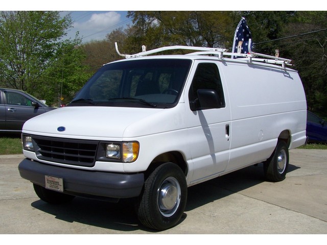

Saw this on ebay the other day...http://www.ebay.com/itm/261904747877?_trksid=p2060353.m1438.l2649&ssPageName=STRK:MEBIDX:IT
