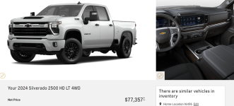

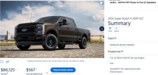

Around here anyway, the GM's seems to go for a fair bit less.
All of these are mid level (XLT / LT / Big Horn) gas pot 3/4 tons. I added a few mod cons but kept it equal - heated seats, tow pkgs, sport pkg (sport pkg is required to get heated seats on the Ford.)

From poking around the
I have no clue about the new market. The OP stated up to five years old. The 6.2 Fords don't hold value compared to the other options. It's is a dated engine but it's reliable and more than capable of carrying a camper.
For sure. Just figured all thing being equal the price discrepancy might continue in the used market. Provided you are comparing trucks of a similar year, equipment level, condition & mileage.
