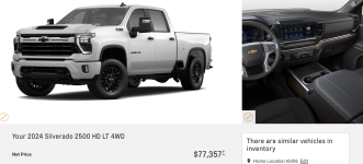

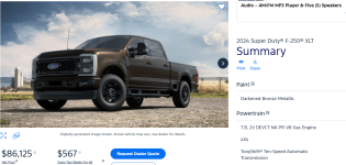

Around here anyway, the GM's seems to go for a fair bit less.
All of these are mid level (XLT / LT / Big Horn) gas pot 3/4 tons. I added a few mod cons but kept it equal - heated seats, tow pkgs, sport pkg (sport pkg is required to get heated seats on the Ford.)

For sure. Just figured all thing being equal the price discrepancy might continue in the used market. Provided you are comparing trucks of a similar year, equipment level, condition & mileage.
