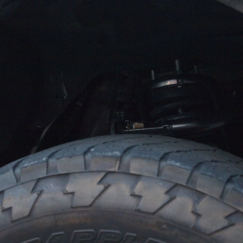

xcmountain80
295's with no tread
315 with full tread but not going to stay (long story see below)
LR UCA's
Well the 315's were short lived, I bought them used but with low miles and they cleaned up beautifully. The tires had been sitting but didn't look to have been affected. I then had them installed and the balance wasn't great, had them balanced again and the balance was still bad, 3rd times the charm... and a phone call stating one of the tires was starting to seperate in the tread and the other may soon follow. Dang I though I just covered almost 500 miles with those I'm glad nothing happened. But on the 156 mile return trip home with crappy unbalanced tires my alternator decided to give out (32 miles from the parents house) and keep me from putting any more miles on the tires (Divine intervention? you be the judge). I called around and found a set of 295's (previous size for 2 sets totalling just over 100K) $986 installed through a Goodyear Dealer. The Nitto TG's are my go to favorite and work in 95% of my driving (Interco Super Swampers make up the other 5% if I had to choose) this is my 7th set, 3rd on the 4Runner.
Notes on the 315's other than bad balance, the ride height increased about 1/2", the 4.88's weren't as happy pushing these compared to the 295's. There was obvious tire rub at full lock on the road, offroad would increase this exponentially, I could feel the added weight while braking even with my upgraded Tundra 231mm brakes. I liked them but didn't feel they were a great fit for the 4Runner. A 35x10.50 could be fun...... but I would have to step the brakes down to accomidate a 15" rim...NOPE
