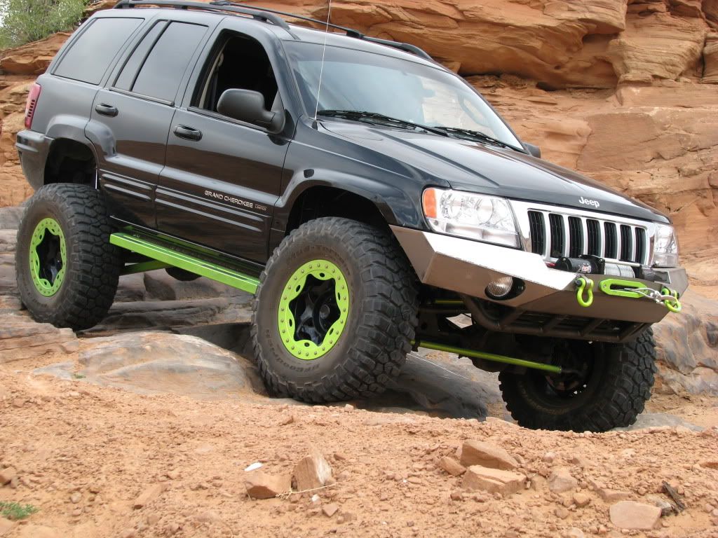

That LSR is sick. I have seen it up close at GSW and it is very well thought out. You will pay for it though. As for clearance any of those will help with clearance, the plastic bumper hangs low on a WJ. If you are not into rock crawling I think any of them are fine choices.

LSR is the only one that doesnt look like a kid with an underbite however it all depends on how it attaches to the unibody and how strong the bumper is itself.

If you look it up on Jeep forum, I think, you can find his build thread if the first one. Then he modified the design to make it better. A freind was looking for a front bumper for his WJ and we researched them all. I met the builder once, but I don't have anything to do with this product. I know it is super stout and a great rock crawling bumper.

The Iceland Offroad Bumper/Flare Combo and the LSR Bumper are close to the same price. The LSR bumper definitely seems solid and Im sure is more than enough for what I'll use it for.
I read the build thread on Pirate4x4. Its definitely an awesome bumper and I considered building one similar to it. He definitely has a lot of work into the design of it.
