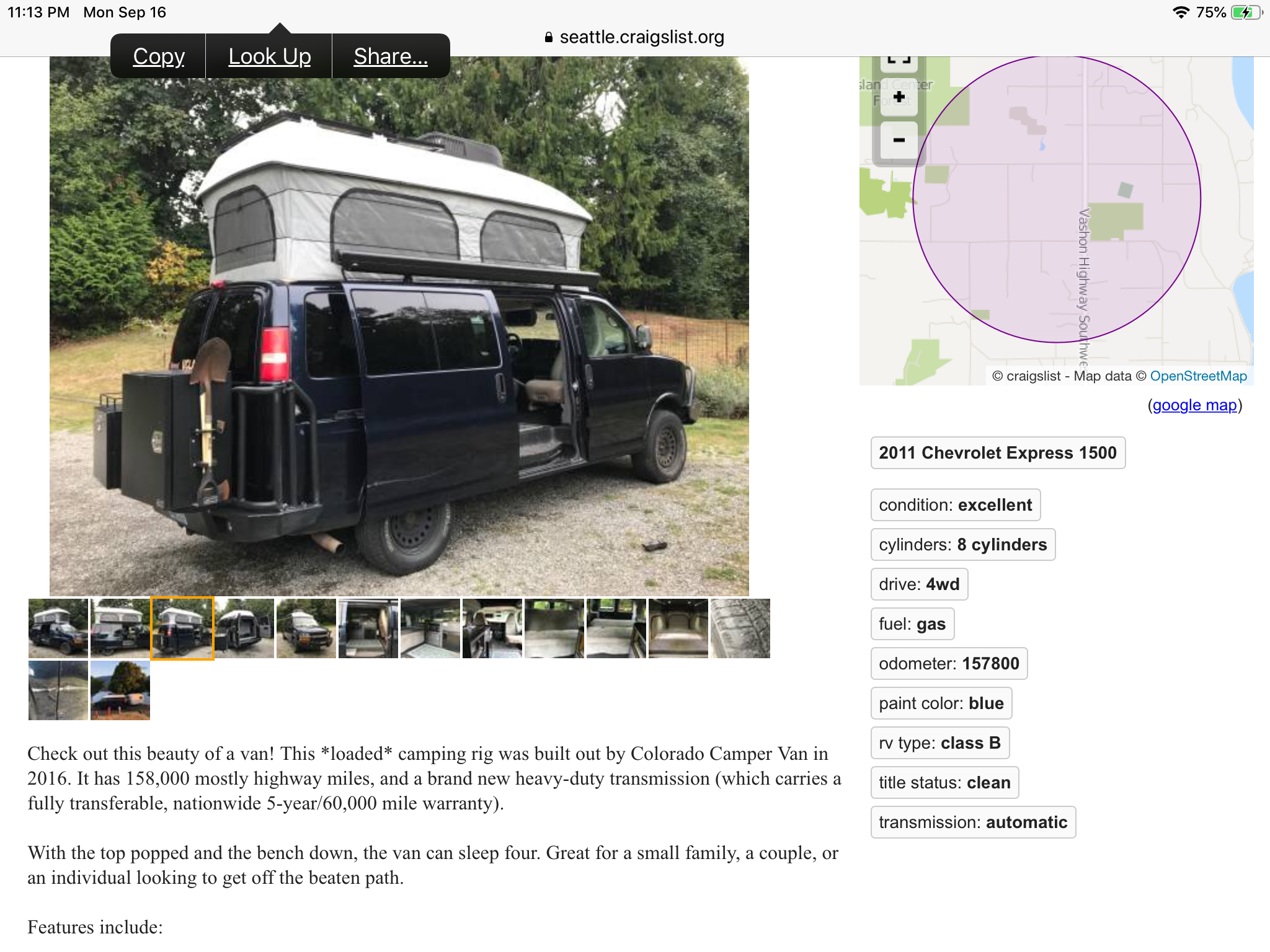

2011 Chevrolet Express AWD Camper Van
NOT MINE....Re-Posted Here For Your Benefit, Enjoy

I test drove this rig a few days ago, and was impressed. However, I'm looking for some advice about the reliability of the vehicle - in particular, the engine. Any info would be much appreciated. Also, given the fairly high asking price, I'm wondering if I should wait and look for something comparable that doesn't cost as much.
Thanks in advance for any help and advice.

I wouldn't worry about the engine much. At 150k it's not young and not old. Chevy 5.3l's are known to go hundreds of thousands of miles. I've driven/owned a few with 250-300k and still going strong. When and if it does die it's one of the most common late model engines out there. A warrantied used one would probably set you back maybe $1k. My current Chevy crew cab with the 5.3l has 240k on it and a Chevy AWD van I had recently had over 200k, both still funning great.
That van looks like it just needs tires and some paint for that top pronto!

Man, I appreciate the advice and comments from you guys! I had done some research about the engine and felt pretty good about it, and your input confirms what I had read. Also, a neighbor who builds and restores classic cars said pretty much the same thing.
86scotty, I'm curious what you meant about the paint for the top - could you clarify that for me?
If I do purchase the van I plan on putting new tires (and maybe wheels) on it - any recommendations on those?
I just sent an email to the owner to see if I can take it for another test drive and to look it over a little more closely.
Thanks!
