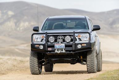

To the best of my knowledge, ARB is the ONLY front bumper made that is actually airbag CERTIFIED (a big difference to "compatible")
I’ve heard this before, yet I’m left with a question:
Who certifies compatibility of a bumper and an airbag system?
The vehicle manufacturer? The bumper manufacturer? A government entity? Takada?
I would seriously like to know who and how certification takes place and to what standard.
I’m curious too...
BUT... I have piece of mind that a giant company like that would have valid certs from the right safety agencies to be making those claims, liability Reasons obviously
A lot moreso than some Instagram Popular brand stating they bumpers are “airbag compatible”

Its right on their site...
AIR BAG COMPATIBILITY
With an air bag equipped 4x4 it is essential that the vehicle's crush rate and air bag triggering is not altered when a bull bar is installed. To ensure compatibility, ARB assesses each vehicle's frontal crush characteristics and replicates the crush rate into the design of each air bag compatible bull bar and its mounting system. This method enables engineers to achieve maximum possible vehicle and passenger protection without affecting the crash pulse. ARB has invested heavily in vehicle crash barrier tests to validate the performance and compliance of its air bag compatible bull bars, and as a consequence, our bars offer a far greater level of protection than most standard brush guards and grille guards.
Please note that a few of the bumpers for older model vehicles are not air-bag compatible, refer to the Vehicle Application Guide for confirmation.

This is one of those critical things saving $ and weight shouldn't apply to. To the best of my knowledge, ARB is the ONLY front bumper made that is actually airbag CERTIFIED (a big difference to "compatible")
Buckstop is about as tough as it gets for animal strikes and having had 3 close calls with animals bigger than my truck up north, the decision is a no brainer for me.
