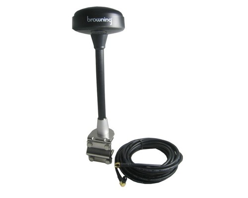

I've no idea if you have a practical place to mount it, but I used an antenna conceptually similar to this on my Mog and it worked well:
http://www.ebay.com/itm/Browning-Tr...703?pt=LH_DefaultDomain_0&hash=item5671ec91df
