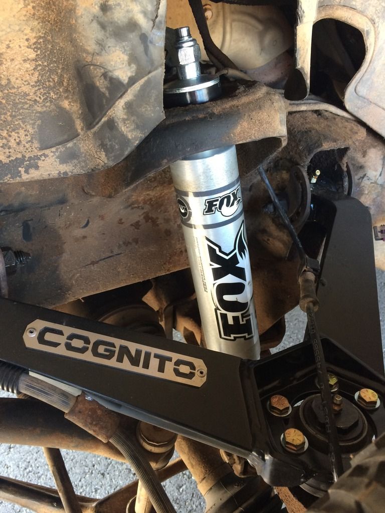

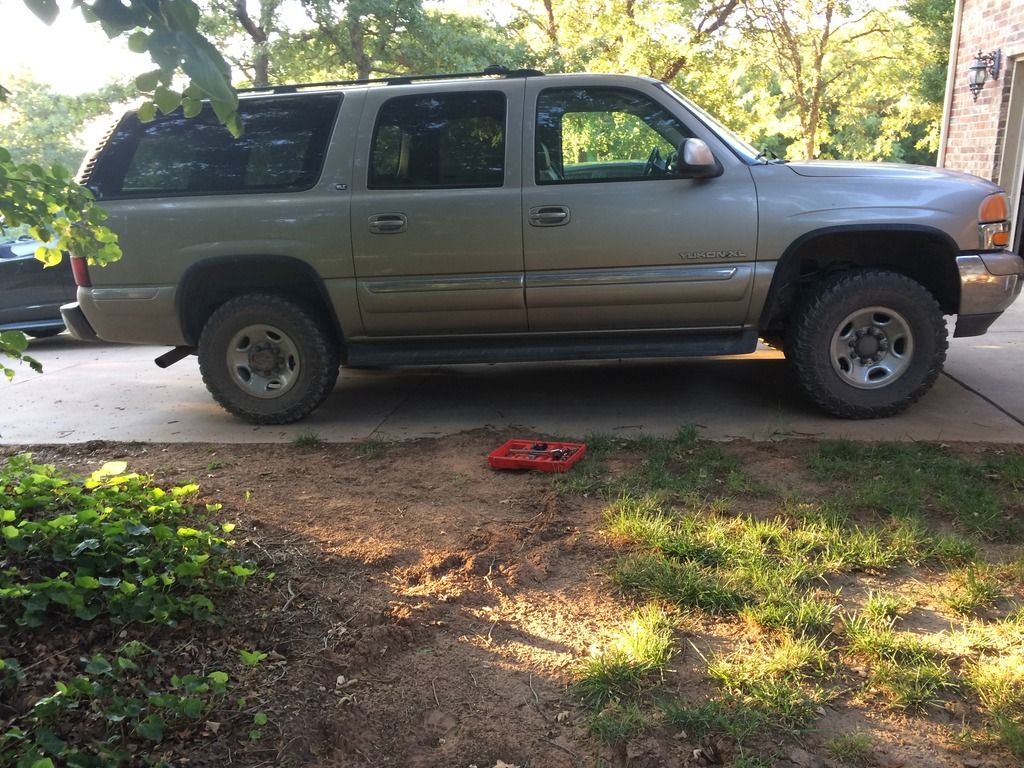

So I finally got around to getting to some fun stuff. Since the truck has AutoRide and I'm pretty sure they're the originals (200k miles now) and they were HORRIBLE off road, or even on dirt roads. So my first step was to crank the torsion bars to level and ordered the stage 6 level kit from NorCal Truck. The kit consists of Cognito UCAs, bolt in ball joints, Fox 2.0 shocks and a pitman arm steering brace.
Sorry I didn't take any install photos, but I get pretty focused while working. Install was really straight forward. I started putting PB Blaster on all the bolts about three days ahead of time which was really helpful. The read drivers shock in a pain to get out, but that's the only issue. I removed all the AutoRide stuff and of course I now have the error dash message. I'll be working on that. It now looks like this...
I can definitely say the ride both off road and on is AWESOME!!! I took a dirt road last night that I could never get over 30mph without flying through the sunroof. Last night I COMFORTABLY hit 55mph and could have gone faster but I was scared of flying off the road because of turns, not the bumps. It was really great!!! Anyone with a GM truck I HIGHLY recommend this setup!!

Nice Yukon! How much lift did you wind up at? Tire size? Are those ball joints proprietary to the suspension, or are they readily available? Anything else to comment regarding the suspension?
Awesome looking XL. Really nice being able to drive the road and not let it drive you! keep the posts coming.
I got 1.75" over where it was with cranking the bars. I don't know if it was stick or not to begin with, but the bars are almost maxed out. Anymore lift and I'd have to get new keys.
I think the BJs are proprietary to Cognito, not sure. I know the 4 bolt mounting plate is proprietary but the actual joint may not be.
Tires are 265/75/16. They were already on the truck before the suspension mods. The PO did some plastic fender cutting. But no other running. The purpose of cranking the bars was only to level out the truck, but I do plan on getting prob 34" tires next year and re-gearing as well.
MPG... Well it's more like GPM. It gets about 11 normal driving. If I cruise empty on the highway at 60-65mph I can get 13. When I pulled my Jayco (5,200#) and 6 passengers to Colorado and back I averaged 6mpg. But it pulled Raton Pass (7% @ 7,800 ft) at 58mph!!
The way the control arms help the suspension is by the shape of the arms. It allows the arm to droop further than the factory arms which really helps when you lift/crank the bars. I did the crank before the arms and I could really tell that the suspension was maxed out. Now it rides better than factory. The Fox 2.0 shocks I spent a lot of time researching. Speaking with technicians at Fox, Cognito and NorCal Truck. Fox actually tested the valving profile on the vehicles to get perfect profiles. Unlike most companies which only "guess" at what the profile should be based on other vehicles. Also, should I want to revalve them I can do so myself and/or rebuild them. Fox says that their proprietary "race" oil they use will perform similar to a reservoir shock. This along with the aluminum body is supposed to really dissipate heat. I can definitely say that on about 2 mi of really rough road at 50mph with the suspension going through full cycle many, many times that I could still hold the shock for 3-5 seconds. So I would guess the temp was less than 120 deg. Fox said the oil should be safe up to well over 300 deg. Many folks that are racing see 400+ Degrees. I haven't towed with the shocks yet, so don't know how they will do.
