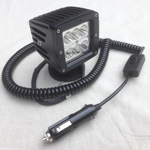

12v string lights under a vehicle awning, the plug in map /work lights. I'm working on a roof-top solar panel mount next and that's what got me started thinking about embedding a power connection in the rear footers of the rack. And that led me to the 12v receptacle / PowerPort idea.
I just haven't found a good 12v plug in light that I like yet.
There are several magnet-base work lights though
Magnetic-Led-spot-light-Cigarette-lighter-on-off-Offroad-Car-truck-head-light-fog-lamp-Crane.jpg_640x640.jpg
