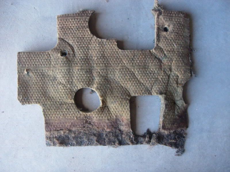

Due to how the heater core leaked, there was a good section of nasty jute on the fire wall too. This jute though, had a rubberized face on it, giving the firewall a cleaner look from the cab. So, I "surgically" removed the nasty section when I was doing the removal of everything else so I could reuse it. I scraped off the old nasty jute, carefully, and used it as a template for the Heat Wave.
You can see at the bottom of the photo how disgusting the jute is, and how much it had absorbed. As a reference, the non-soaked jute was only about 3/8" thick at most, while the soaked stuff was close to an inch...it doesnt dry out even in AZ weather.
