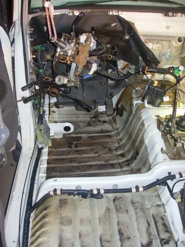

I thought you had already put that back in...? like over a month ago.
How long did it take to pull the dash apart?
Fergie
That was the dealer doing the evaporator for the AC.
Going slow, bagging and tagging all the screws and bolts, I'd say it took roughly 4 hours.

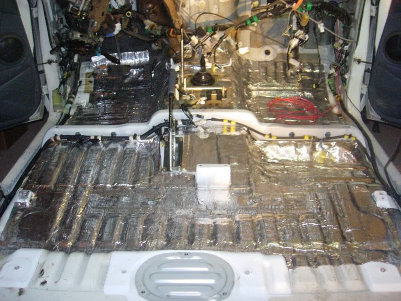

I thoroughly vacuumed everything out, and wiped down all the surfaces with Greased Lightening, then some rubbing alcohol, just in case.
I started applying the Damplifier Pro, after test fitting each sheet as I went. I made lots of relief cuts, and saved all my bits and pieces for fill.
I coverd the front passenger and driver footwells, tranny hump and partially up the firewall with 2 layers of DP. I covered the second row seat area with one layer. I then put an extra sheet of the catalytic converters in the driver's footwell, and and extra sheet over the muffler area, in the the passenger second row area. I used a small wood roller to go over the pieces with, and kept my work light on the area for the extra little bit of heat and pliability.
I used the Damplifier because it is butyl based, and does not have that asphalth smell asscociated with other products. I met with Anthony of Second Skin at his warehouse in PHX, and he walked me through all of his products. I recommend his products to anyone.
