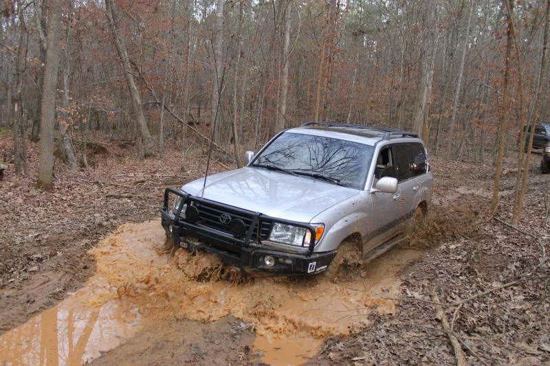

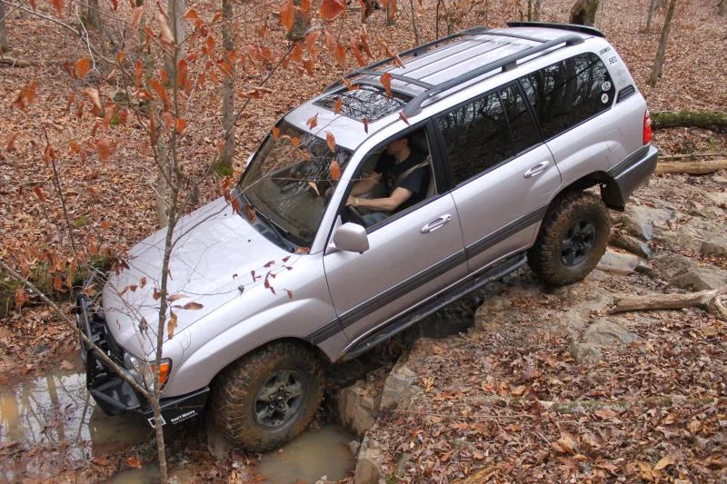

I went wheeling Saturday and gave the "L" shocks a test. Adding 3" of travel at the wheels in the rear has made a huge difference. To recap why I did the "L" shock mod, I have had Bilstein 4600's for the past 2 years. At the time I was not aware of the rear shock length. It is .5" shorter than OEM, and 1" shorter than the standard OME shocks for the 100. I was always on 3 wheels. The "L" shocks are the 80 Series long travel shock from OME. I thoroughly put them through their paces this week, from some higher speed washboard roads to some pretty twisty trails. I will admit, I love them 100%.
Some photo's of this weekend:
attachment.php
attachment.php
attachment.php

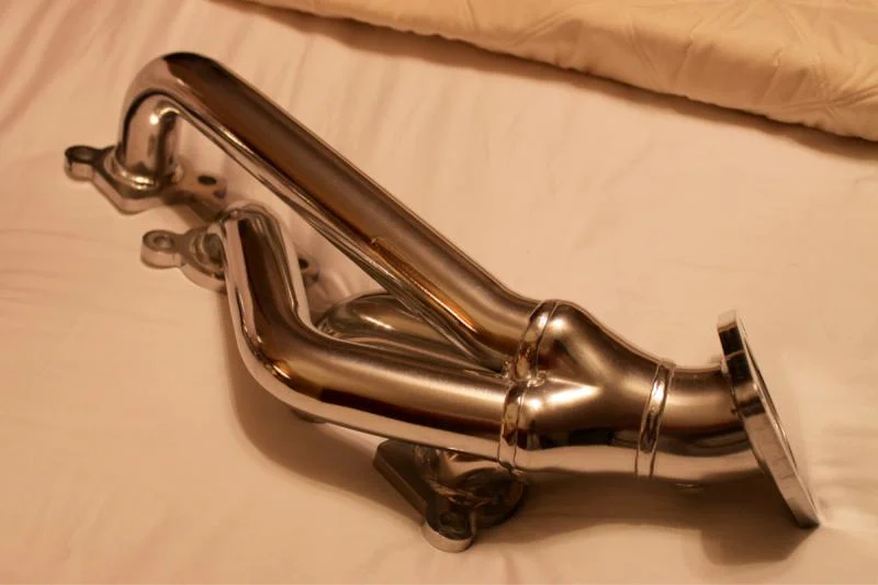

Picked up some headers from DT this past week. Install will be in the next few weeks when I have time. More updates to come when I start exhaust. Other recent projects were clean up the underside again, downsized my subwoofer in anticipation for my drawer build.
