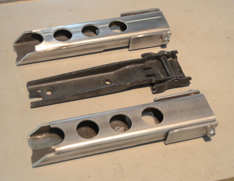

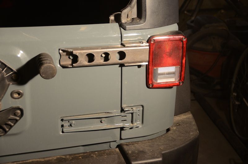

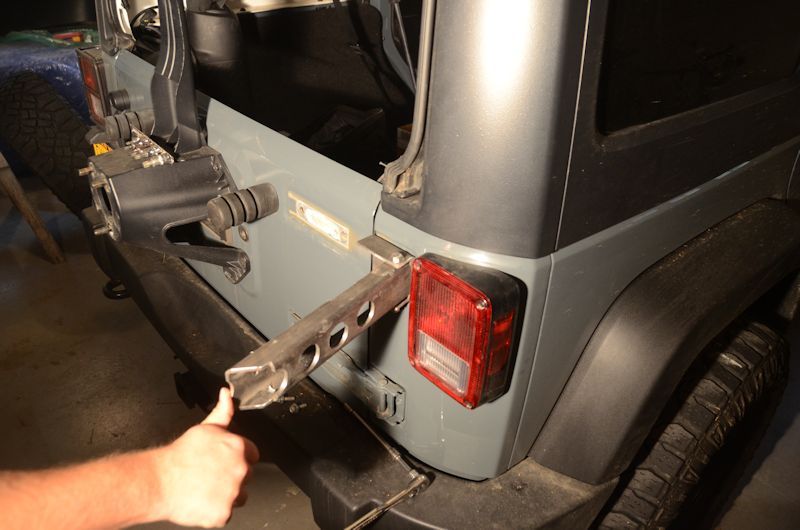

Jeff, wanted to pick your brain on hinge pin alignment for those with the wider upper. My brain tells me that as long as the far right edge of the barn door (the right edge of the upper) is left of the centerline of the hinge pin, then the swing operation should be fine. I went back and tried some investigation into what you did for Tom's, but wanted to confirm I am on the right path. Otherwise, disregard the placement of the washer (I know it will need to be further from the body).
View attachment 764069View attachment 764071
That is correct - the right edge of the barn door needs to be to the left of the hinge pin.
I made these hinges for the wide barn door; they're basically the same as the HD hinges I designed for MORryde, but with the hinge pin moved to the right. In this next photo you can compare the hinge pin location of the stock hinge with the "wide swing" hinges.
TomHinges3_zpsbedd9167.jpg~original
TomHinges2_zps8b97c6ca.jpg~original
TomHinges4_zpsf9ad07e7.jpg~original
For the earlier hardtops with the liftgate the same width as the tailgate, the stock hinges work fine for a barn door.
Thanks Jeff. I ended up knocking these out yesterday. I still need to trim back the the body side bracket, clean everything up, and then get them powder coated. Swings like it came from the factory.
