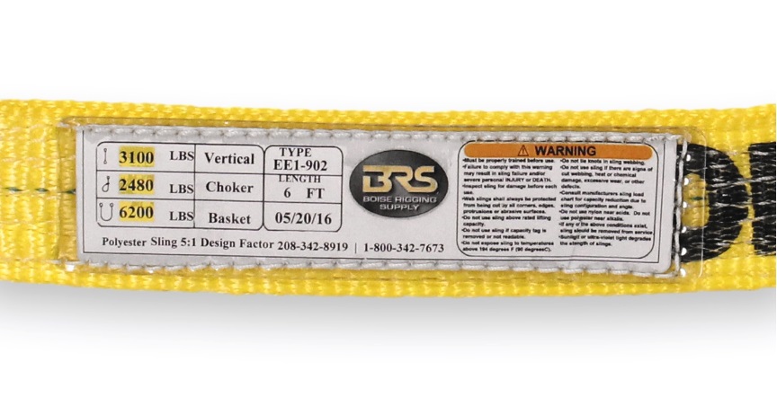

None-the-less, a B30.9 single ply polyester web sling 2" wide would carry various working load limits such as vertical hitch, which is essentially how we rig straps connecting an eye to each vehicle then straight pulling. Rigging straps might also be used in a basket or choke configuration, which have different ratings.
Per the standard a synthetic sling is required to carry a design factor of 5, which is the ratio of breaking to working strength, and be subject to a proof test of 2 x WLL. So an example 3,100 lbf WLL sling would be designed to break at 15,500 lbs and have been tested (and could be again at any time) to 6,200 lbf without damage.
Just a random 2", single ply sling example: https://boiserigging.com/product/2-eye-eye-sling-one-ply-ee1-902/
I suspect that's the very, very lose root of the numbers this Home Depot strap claims. IOW 15,000 lbs max load is the material breaking and 7,000 lbf would probably be (perhaps optimistically, I'd think) what they think is proof - the point it would tear stitching or start to stretch permanently.
