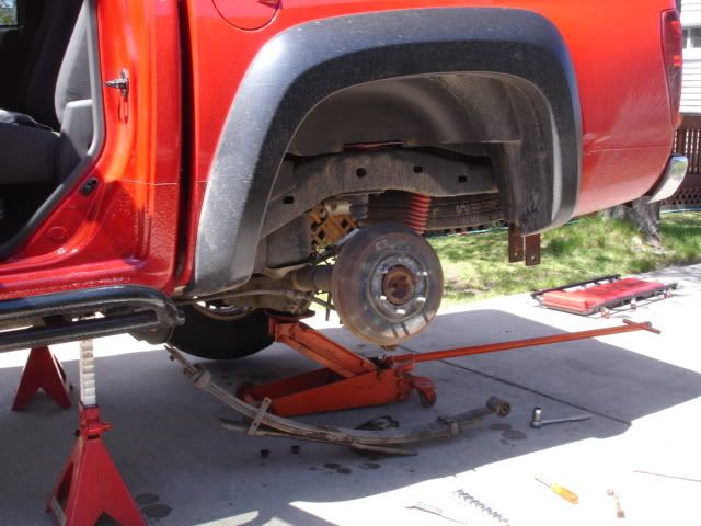

The add-a-leaf is in. Took way longer then is should have. About 6.5 hours. The trouble area was on the reassembly. The passenger side went together just fine but on the driver’s side I had a really hard time lining up the center pin of the leaf spring with the center pin hole on the axle. I finally got it using a ratchet strap to pull everything into alignment.
Work in progress

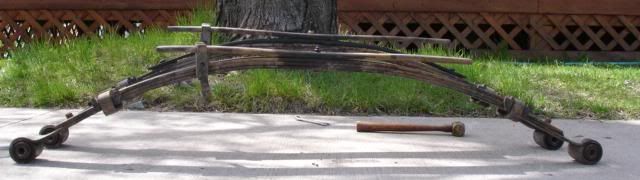

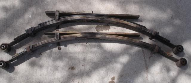

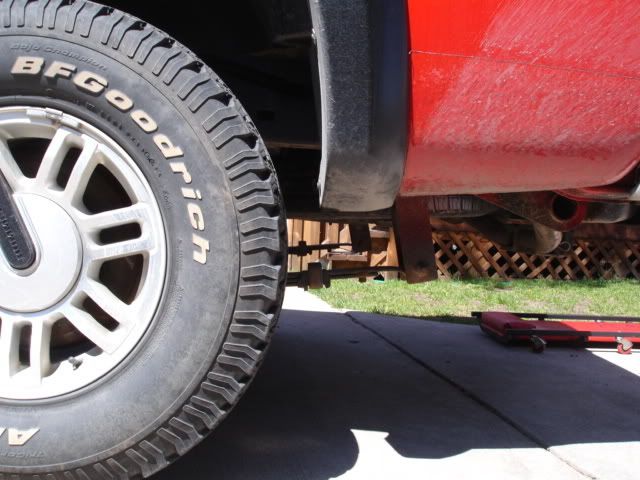

A couple of pictures trying to show the differences in the arch of the springs with and without aal.
top with bottom without
forground without background with

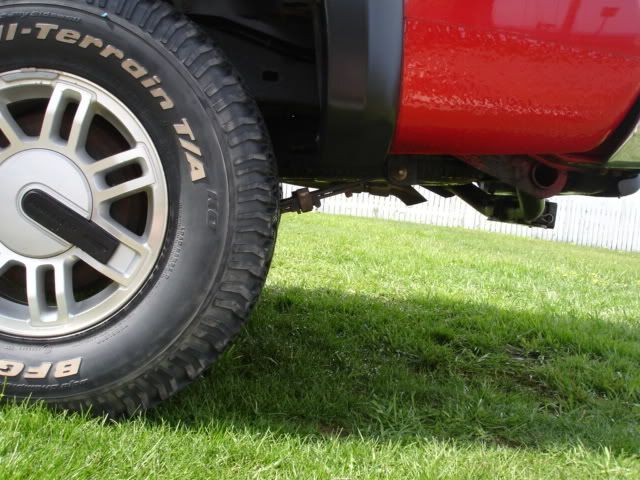

with 2 inch shackle hanging down
with 2.5 inch add-a-leaf
The firmness of the tightened torsion bars and the add-a-leaf seems to be somewhat offset by the softness of not having a sway bar.
i agree, as well as carrying somewhat of a load. i removed my canopy, rack, spare, tool box etc, and found the aals surprisingly more jarring. i measured before and after and lost .5" with approx 350-400 lbs, but the ride was again softer and smoother. good job NE, i also couldn't stand the low 2" shackles.

Looks better, now you don't have that shackle hangin low! You could have saved the hard work by doing one spring at a time, the axle usually stays in line easier that way.
I figured that. It even said to do one side at a time in the instructions I was following. The reason I did them both together is I wanted to compare the arch of the spring before and after aal install. Curiosity kills the cat.
opie
I ended up doing one side without removing the pack. It wasnt by choice. We couldnt get the forward bolt out of the hanger.
It was alot easier though. Only took as 30 minutes for that side as opposed to 2.5 hours for the first side.

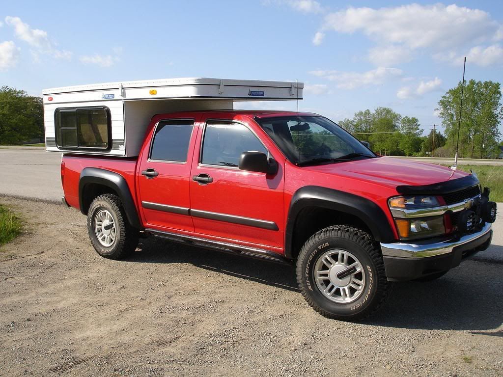

Instant Expedition Vehicle
Just add Four Wheel Camper
It was a long drive there and back to pick it up so here is just a teaser pic for now.

very nice! what comfort. any specs on the weight of the camper? like to see some more side shots. congrats.
upcruiser
Perpetual Transient
Thanks for swinging by last night with it. Now I just have to see it with the top up before the drool factor takes full effect!
