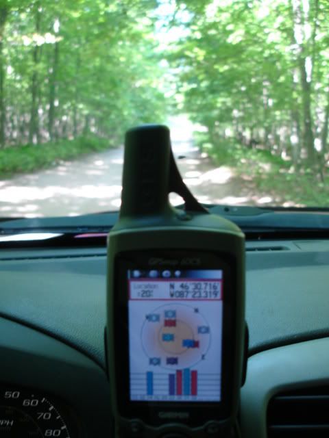

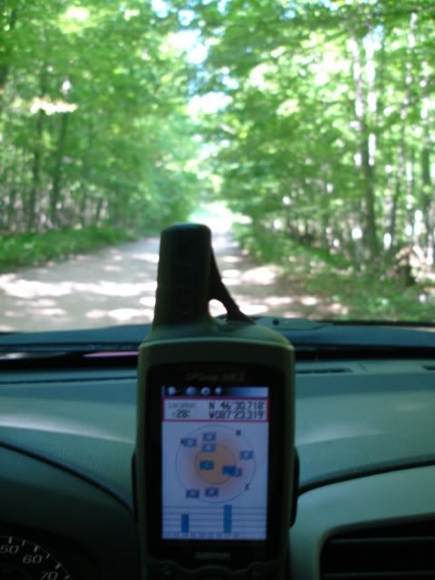

I picked up an external GPS antenna to help get better reception on narrow tree covered roads. In most situations the built in antenna was working just fine but there were those occasions when I would loose the signal. Cloud cover would also contribute to loss of signal.
I put the Antenna in the same spot I have the XM antenna but on the drivers side. I ran the wire behind the dash in the same way I have the power cord set up.
Model GA 25MCX Came with 8 feet of cable
Tree covered road without external antenna plugged in.
Same place with external antenna plugged in

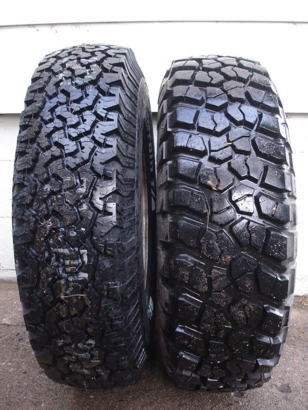

New tires....again.
I replaced my BFG AT 265/75 16's with a set of BFG KM2's this summer. The KM2's have worked great and I would highly recommend them. Now that winter is just around the corner I wanted to put my AT's back on. They have been wearing well and still have a lot of life left in them.
I decided to go a slightly different direction. Instead of paying to have my tires remounted every spring and then again every fall I decided to just get a brand new set of BFG AT's and have them mounted on my original Chevy Colorado rims. I decided to go with 33x9.5 on my Chevy 15x6.5 rims. They are slightly taller and this setup weights 12 pounds less per tire. I'm hoping this will help with gas milage.
The old AT's will be saved for my wife's Xterra.
