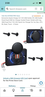

I ran a USB/ USB mini and an Apple lightning cable from the tape deck door to the glove box. The first cable went slick. I don’t know if I was just lucky or what because the second I messed with for an hour before I was happy. I hate sitting on my head.
Anyhow… I ran a 10 AWG double wire from the Blues Sea fuse box (see above) through the channel under both passenger side doors, up the kick panel and to the rear of the glove box. I found some pretty cool flush mount USB ports on Amazon and wired it all up.
