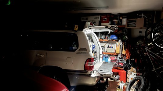

Nice thing is that the install of the 100ah mini with the terminals facing the rear of the truck allows for significant storage yet under the wing. My Eno nest set up and the Nemo Cosmo 3D both fit. Te terminals are protected by the back trim plate. A footmans loop attached to the drawer frame secures the battery strap.
