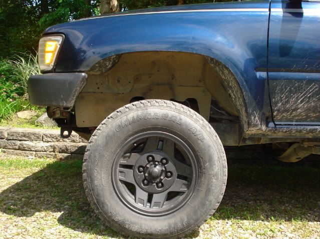

Here's my '91 with LC coils in the rear and torsion bars cranked. Waiting for ball joint spacers and tires before I attempt to wheel it though. It currently has 235/75's on it but I think 33's would fit with no problem. I'm gonna go with 31's because of the 3.slow w/ the auto tranny.
